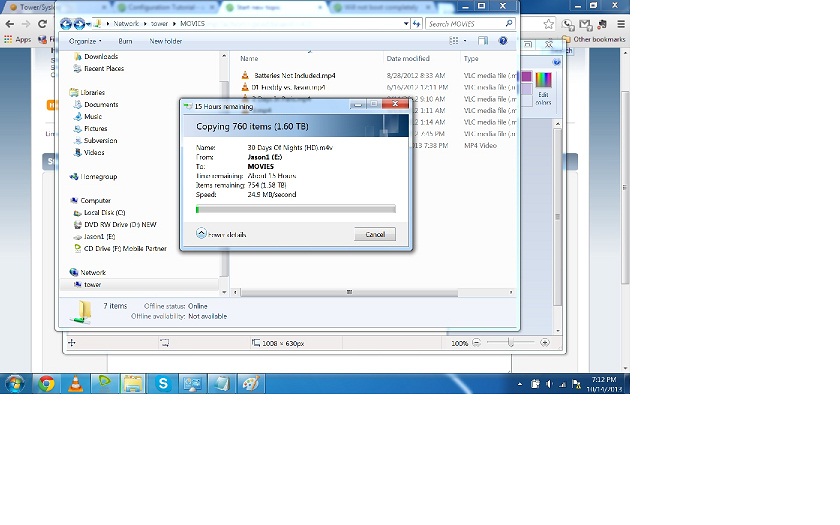

I have connected the unraid server directly to the laptop via a Cat5e cable (the only one I have out here in Afghanistan).  The system is only transferring at 26ish mbs.  At this rate I am looking at well over 20 hours per disc to get the data into the array.

Thanks for the info but I tried those registry tweeks as well as a couple more I found but no luck.  Starts out at around 200mbs and goes to 25-29mbs within a minute or so.  Very odd.

.............Starts out at around 200mbs and goes to 25-29mbs within a minute or so.  Very odd.
It might be a good time to post another syslog; if at all possible one from startup through a point where the copying slowdown is occurring. Thanks!
