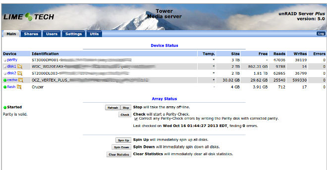

October 22, 201313 yr Attached is a view of the stock webGUI from Lime Tech as a point of reference. It listens on port 80.
October 22, 201313 yr Attached is a view of the stock webGUI from Lime Tech as a point of reference. It listens on port 80. can you post a pic of the enhanced gui for reference? i know what unmenu on 8080 looks like are we talking about something different?
October 22, 201313 yr Here's an image of the enhanced webGUI from Lime Tech; taken from the thread: http://lime-technology.com/forum/index.php?topic=28839.0
