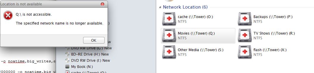

The system has crashed as before - fans are running, shares are not accessible!

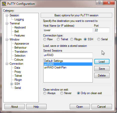

Well putty configuration has not changed before and after the reinstall, and it is after the reinstall that putty was not working. My saved unRaid profile is what I am cliking on to try and get connected, but I either get timed out or the host cannot be found error. Host name: tower; Port: 22; Type: ssh. (screenshot attached). So not sure what I am doign wrong!!!
The other saved putty profile was for crashplan, but since the new install is stock I have not installed crashplan yet.
Anyways does the telenet issue help explaining the crashes or were you just curious? Because even with a monitor attached I can see that the ystem becomes unresponsive. Since the last update I even ran a flash drive check and found no errors at all. unRaid still crashes, any indication of what is causing this from the log files.
putty screenshot.

My Putty profile for unRAID is for Telnet on port 23. I don't think SSH is stock out-of-the-box.
Okay maybe that is what is not woking.
So if I change it to port 23 and telnet it should work right? But does that give us any clue as to why the system is crashing. Or are these 2 seperate issues?
