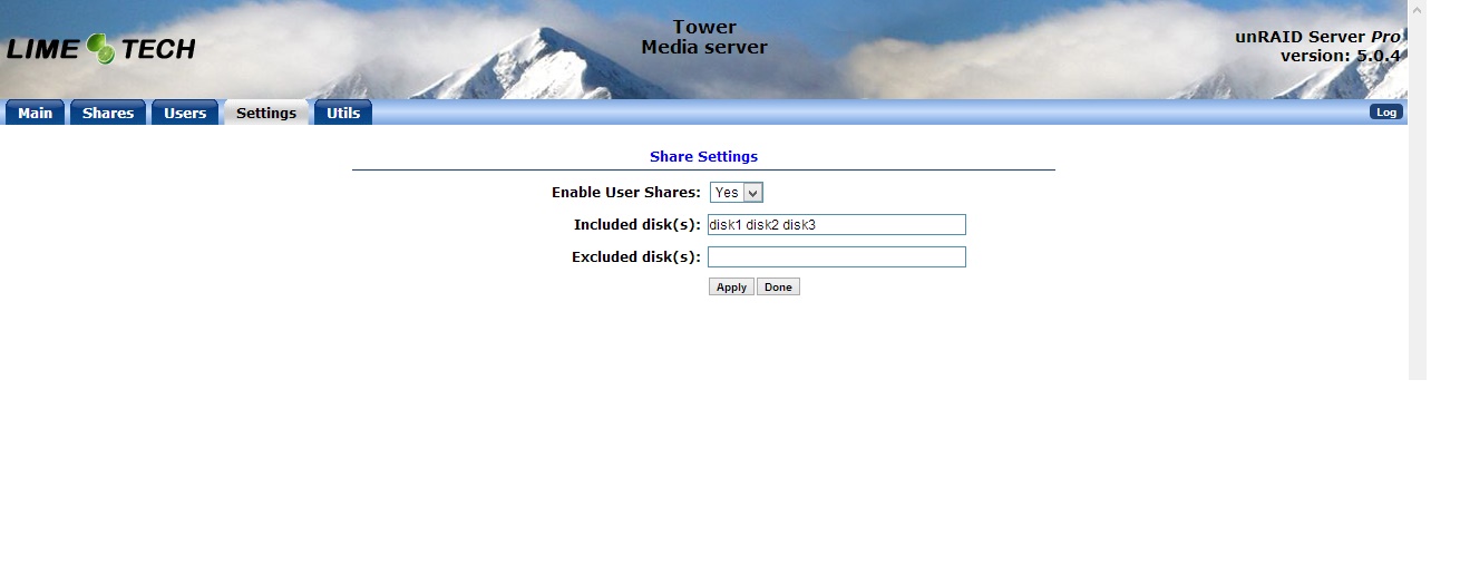

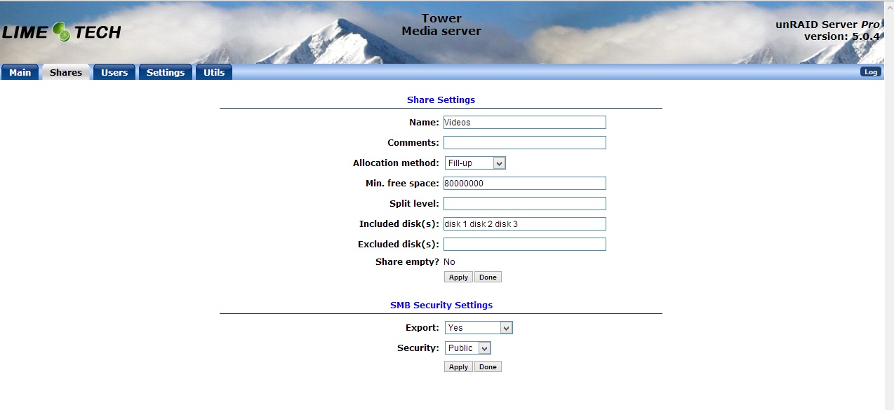

I want to use the new disk but I am having problems with getting the share folder on the new disk.
I have attached my shares settings. I have accidentally added my second disk to the shares but the third is not so lucky!
The disks are disk1, disk2, disk3, etc. => not disk 1, disk 2, etc. (i.e. no space between "disk" and the number.    In addition, you should separate them with commas.
e.g. to include disks 1-4, you'd use
disk1,disk2,disk3,disk4
I have tried this. Videos shared folder on disk 3 still does not show up.  :o
What do you mean by "does not show up" ??
Are you expecting a "Videos" folder to be created on Disk3 just because you added it to the share?  That's NOT the way it works.  Adding Disk3 to the share means disk3 will now be used for that share WHEN it is needed.    It does NOT create that folder until it's actually going to write to that disk.
If you change your share's allocation method to "Most free", then (assuming this is a new disk and has more space available than any other disk in the share) the next write to that share will be to Disk3 ... and this will cause the folder to be created.
