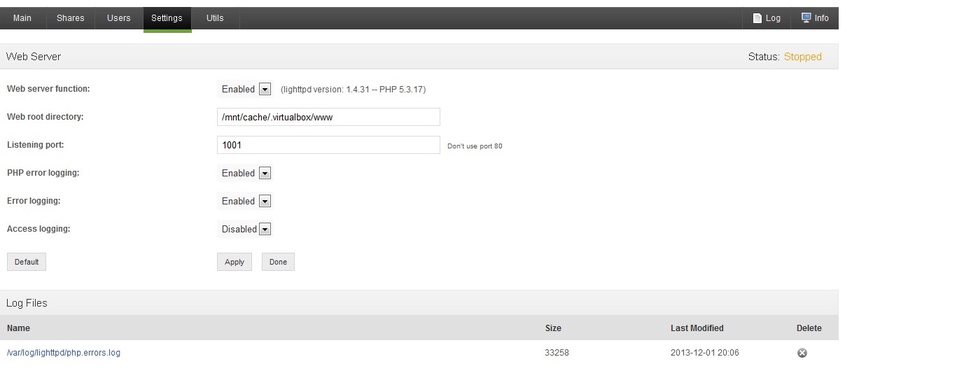

@nacat78 - maybe I will have to go back to 5.02 and test if I cannot get this working.  However, all of the errors have gone away, but I do not see a way to start the web server.  Screenshot attached.
I have it set to enabled, but it says STATUS stopped.
Looks like it cannot see hidden files.

@wisem2540 - verify that you have a folder on your cache share labeled .virtualbox/www - this is also where you need to unpack phpvirtualbox contents

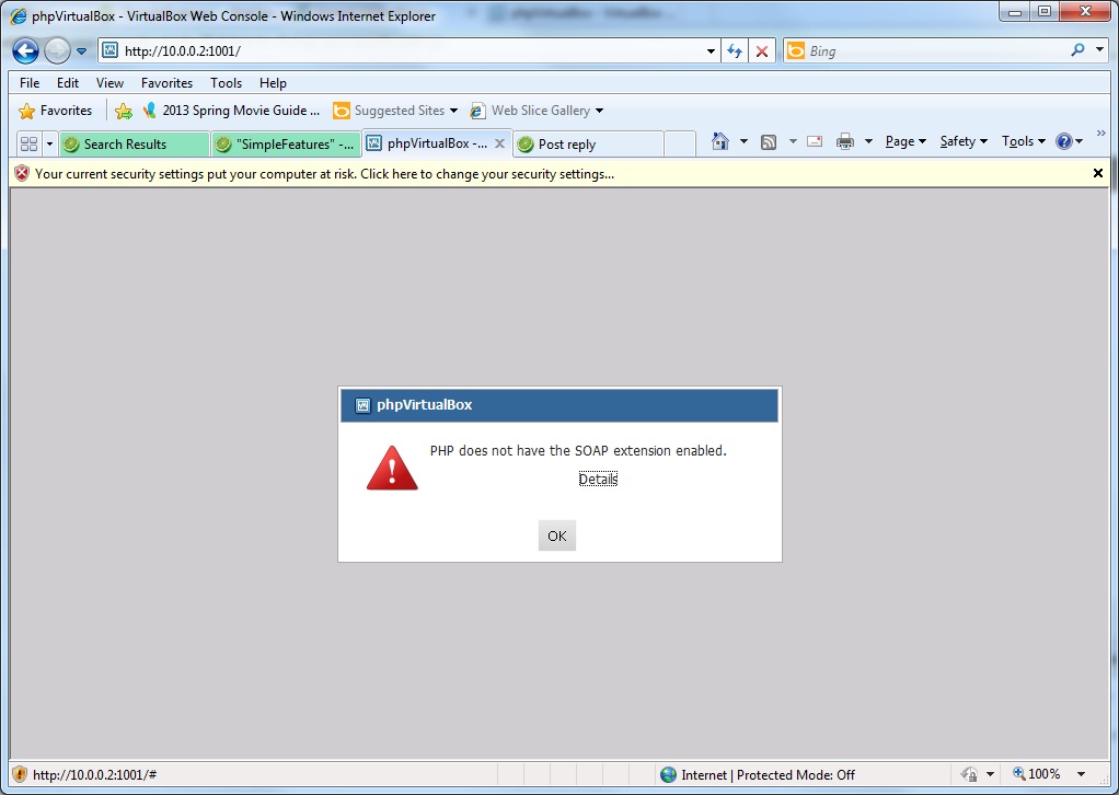

ok for the soap extension error you need to open php.ini file located in boot\config\simpleFeatures folder and remove the exception for so.soap - so with file open search for
so;extension=soap and make it soextension=soap, save file, close and restart webserver

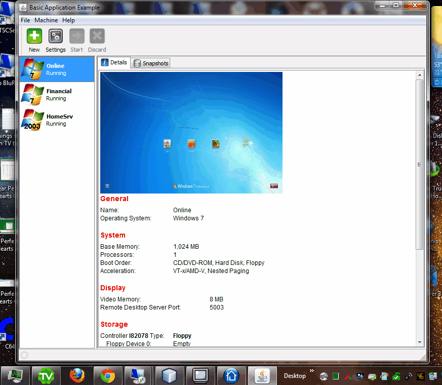

I use the command line to setup and control my VMs currently.  Although I hope to have a Java desktop app (that doesn't need a webserver to setup and control VirtualBox on unRAID) done early next year.  It is currently only able to display the VMs and ONLY that.  So in other words I only have the easy stuff done.  It may just become vaporware if I don't get time to work on it.  I can post screen shots when I am home if any interest is expressed.
Edit:  Added Teaser screen of the little I have working in the Java desktop app.  The graphic shows a dialog on my Windows desktop displaying the information of one of the VMs on my unRAID host (N54L box) - actually the one I use to access the forums but will be updating the memory on this VM to 2GB once I get that far in the app.  It does not use a webserver to display it and only requires vboxwebsrv running on unRAID host.
