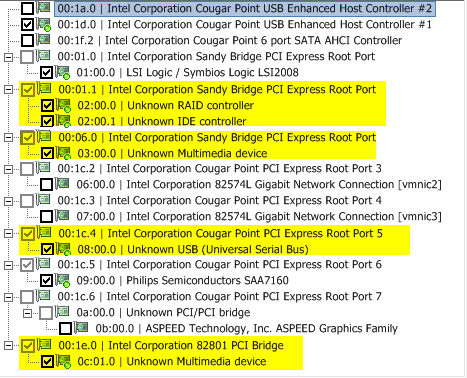

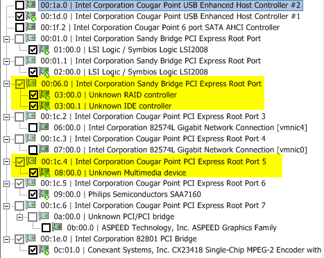

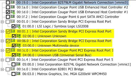

ESXi server 0:
SuperMicro X9SCM-F MB.  01:00.0 M1015, 02:00.0 Asm1061, 03:00.0 HVR-2250 & 04:00.0 USB 3.0
ESXi server1:
Tyan S5512GM2NR MB. 01:00.0 M1015, 02:00.0 & 02:00.1 RR622 (Marvell 99SE9128), 03:00.0 HVR-2250, 08:00.0 USB 3.0, 09:00.0 AVerMedia Duet, 0c:01.0 nVidia DualTV
ESXi server2:
Tyan S5512GM2NR MB. 01:00.0 M1015, 02:00.0 M1015, 03:00.0 & 03:00.1 RR622 (Marvell 99SE9128), 08:00.0 HVR-2250, 09:00.0 AVerMedia Duet, 0c:01.0 HVR-1600
So for me the ASM 1061 controller works and the 99SE9128 controller work.  So it may be due to your models since I see you said it was ASM 1062 & Marvel 88SE9120.  Note I also had a PCI-X controller based on Marvel 88SX6081 on pass through in ESXi server2.
The highlighting was just to show what the unknown controllers look like.
