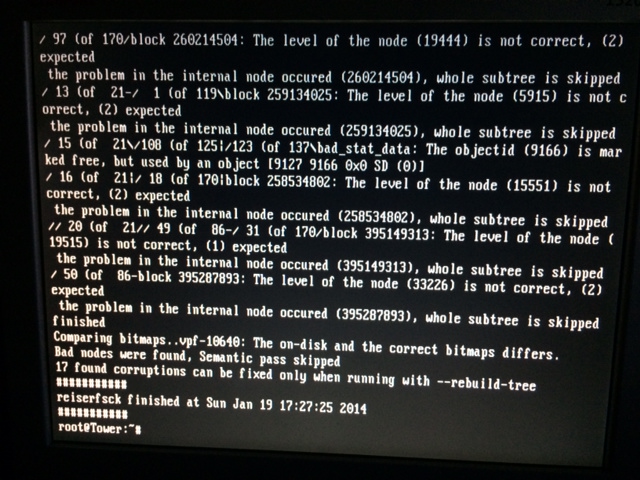

I did a parity check which stopped by itself, after which the server wasn't reachable anymore. At the console I saw some errors on md8.
I ran reiserfsck --check /dev/md8 . You can see the result on the picture. I wonder where I can find the log info (which is supposed to be put out to 'stdout' somewhere?).
What should I do or type next to fix the problem? Just type --rebuild-tree ??

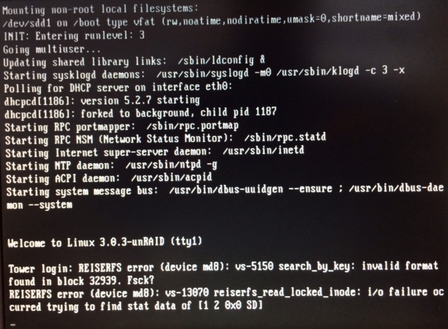

I rebooted the server. When starting the array, disk8 shows up as unformatted.
On the console I see "REISERFS error (device md8)" and a lot of other things, see picture.
What should I do next?
Replace the disk?
No. Replacing the disk will not fix the file system. Run reiserfsck with the rebuild-tree option as indicated in the first screenshot.

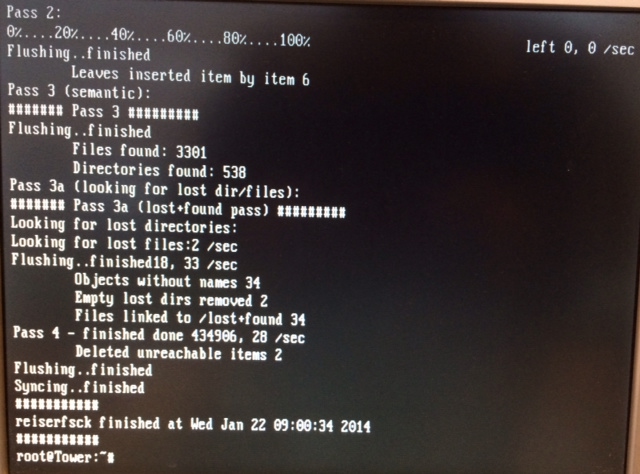

The process finished this morning after 33 hours. You can see the result in the picture. Does it look good?
I rebooted my server and started the array, after which parity build started by itself. After this, I will start a parity check and see what happens..
