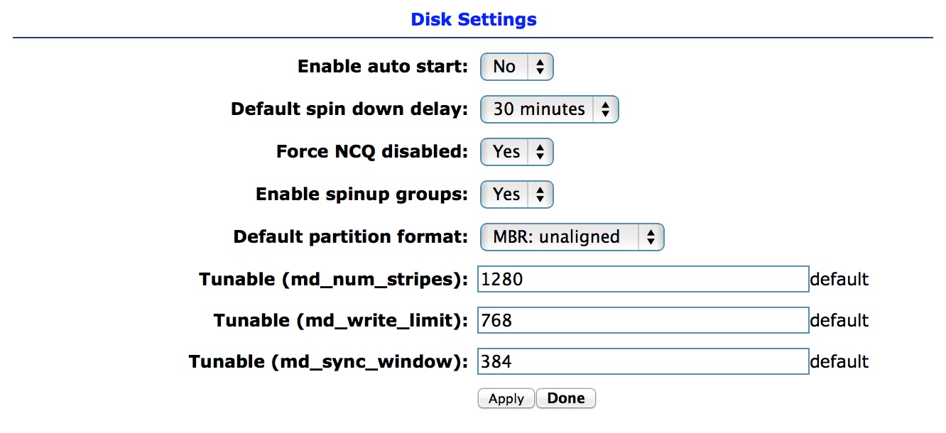

Have 5.0.4 running with 4TB Seagate ST4000DM000 and just saw in the Disk Settings that unRAID is running with the "default partition format" MBR: unaligned.
Shouldn't I change this to aligned?
Was it not that all 4TB disks are aligned anyway?

I have only 4TB drives in that array and all should be 64k aligned. Thus I wondered about this setting. Should I set to 64k aligned? It doesn't recognize the drives and the default is 63k unaligned... wondering why is this.

Ok. The alignment option in Disk Settings is unaligned by default (see snapshot), also not checking actual alignment/unalignment of disks.
It should be set to 4K-aligned. Do not worry about the current disks.
Ok, thx. What about NCQ, native command queing?
But isn't NCQ actually a good thing to have. The ST4000DM000 support NCQ.
The default setting is Yes. Change it and see if your system works better. The default was picked to work best with unRAID.
