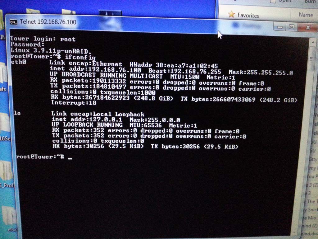

Copied about 290Gb from the UnRAID server to my laptop then copied it back.
Ifconfig attached
New SYSLOG attached too!
log.txt
ifconfig has zero errors. The switch or router, maybe only one port, is bad. Or the cable was bad.
