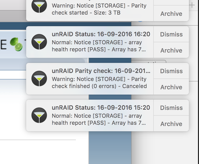

If I were to integrate support for the inbuilt unRAID notifications in version 6.0, would you like it to replicate the webGUI functionality via the OS notification centre? Example, shows an alert that stays visible until you 'Archive' it. Archiving it will remove the notification from the webGUI (like you pressed the 'x' in the webGUI).
I like that, It would give a better chance of seeing higher priority notifications. I sometimes miss the email ones coming through when I'm busy at work. I have a slight panic attack when I look back at them later and see a UPS warning came in.
Not to mention, unRaid has been so rock solid for the last few years that only the "PASS" email comes through.
I'm sure whatever you decide will work for us though. If not someone will tell you.
Would you want only warning and above alerts (not notice)? Curren't it's set to show all alerts that you set to display in the browser.
IMO i like them all.
Docker Image Alerts come across as a notice I believe.
Even though it's overkill, I like knowing everything that's going on.
I even like being notified of app updates in case there is a problem I can remember/recall that that app updated very recently.
Strictly my opinion though.

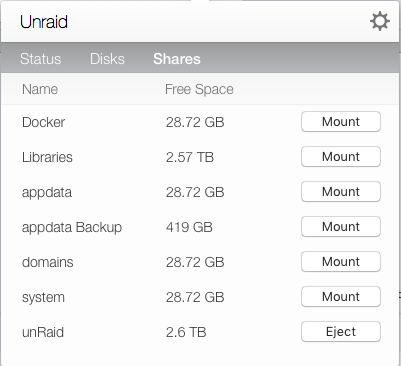

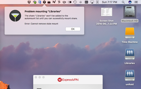

Can you maybe explain this. Giving me that error when I hit the mount button. Tried unmounting everything and starting over. Tried restarting mac.
The disk area button says "Mount" and not "Eject" like my unRaid share.
Even though it's mounted.
EDIT: Oh, BTW this is a Sierra machine.

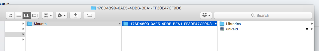

Interesting. Can you please go to directory: ~/Library/Containers/nz.co.pixeleyes.Margarita/Data/Library/Application Support/Margarita/Mounts
Let me know what's in it.
Cheers
This is here because you can't have an empty message body
Any files in the Libraries folder?
Nope, Empty. unRaid folder/mount is as though I am browsing it. All files are there.
OK - it's definitely a stale mount, so Libraries must be mounted via another means (ie, Finder).
Please remove that folder. I'll add some code in to remove stale mounts if they are empty, and will make the error message more verbose if it's not.
