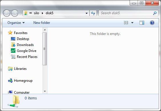

At the moment \\tower\disk5 exists but there is nothing in there.

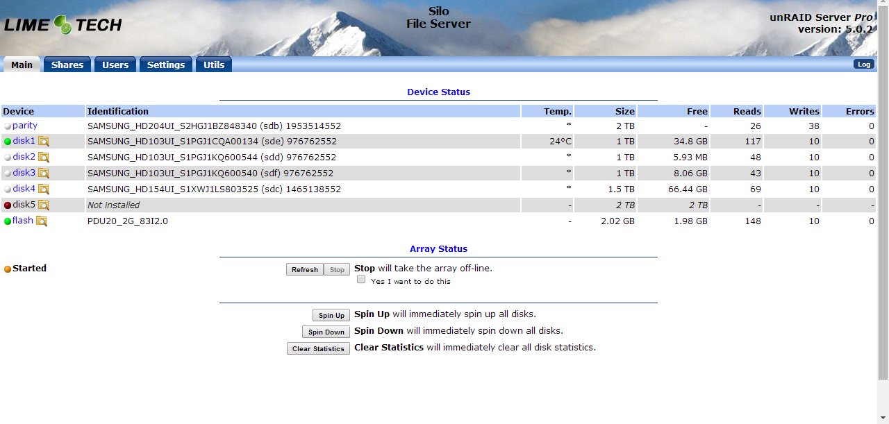

If i physically remove disk5 now and start the array with the addition of some of these spare new 1tb's drives i have (smaller than the failed disk) will it still try and simulate disk5's data?
In THIS POST disk5 was being simulated. If you get back to this state it will again be simulated. The array will not start unless either all disks are present, or all disks but one are present (and the missing one is simulated). Are you certain that you did not get a message that a disk was not formatted and select the format option. If this you did that this situation would make more sense and I'd have more confidence the procedure below would help.

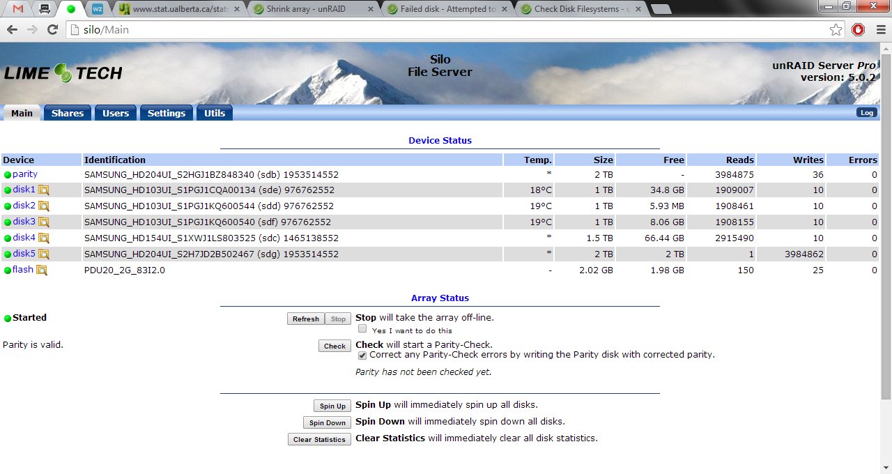

disk5 has rebuilt - apparently without error.  However there is nothing on it.  See attached screenshot.
Should I run a parity check as indicated in the screenshot or should I stop the array, remove the disk and see what it simulates?
