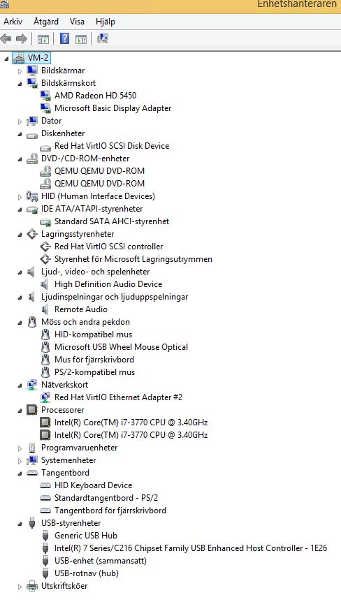

New config file, this defiantly pass-trough my GPU/USB, see attached image.
//Peter

New updated config file
//P

what happens if you do this command ?
I do ....
virsh define windows8.xml and then
virsh start windows8
EDIT
with
virsh create windows8.xml
Works with no issue as well, maybe you did add something bad to the xml file ?

//Peter
