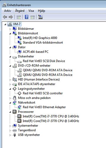

Intel HD Graphics 4000 Pass trough SUCCESS!!
Manage to pass trough my HD graphics 4000 to my W7 machine!
I was partly successful with W8 as well, it was passing trough the device, I could update the drivers for Intel HD, after that all was OK!, but after reboot it will not start, I got the "blue screen of death" I will try to uninstall all drivers from my previuse GPU, and see if this is the route cause.
//Peter
Fantastic news.  I might revisit this if you can get yours stable.  My HD5550 died, so I don't have any other card to try, but if you can get iGPU working, I'll spend some more time fighting my system to get this working.
Please keep us posted.
Anyone that can try this settings for Intel GPU? change to your devices.
 <qemu:commandline>
    <qemu:arg value='-device'/>
    <qemu:arg value='vfio-pci,host=00:02.0,bus=pcie.0,multifunction=on'/>
    <qemu:arg value='vfio-pci,host=00:1d.0,bus=pcie.0'/>
  </qemu:commandline>
//Peter

Anyone that can try this settings? change to your devices.
 <qemu:commandline>
  </qemu:commandline>
What devices are they (00:02.0 & 00:1d.0)?  I assume one is the iGPU, and the other is something unrelated.  If correct, you're not passing the HDMI Audio of the iGPU in this case, so how are you passing the sound out of the VM?
