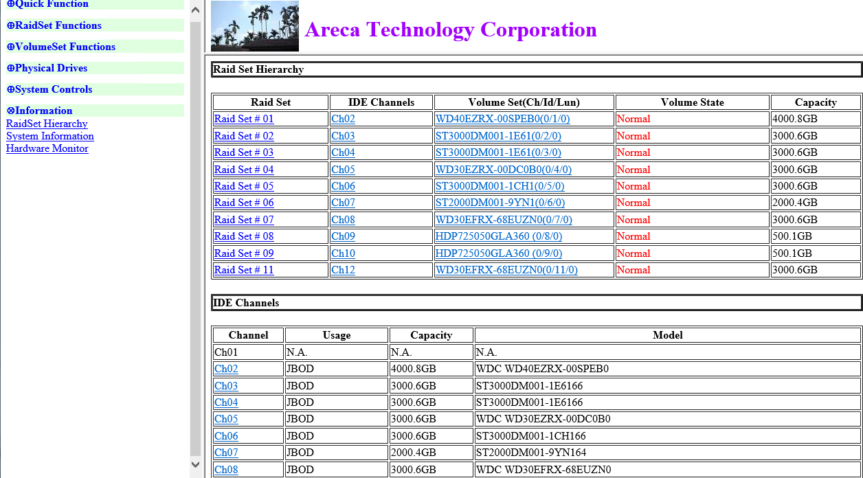

November 6, 201412 yr I've attached a screenshot for comparison. My drives are configured as "RAID Set" (Raid0 single drive) automatically when I plug them in. I have a much older controller with older firmware but I just purchased a ARC-1280ML so I'll see how that works in a new server I'm building.

December 29, 201411 yr Author I've attached a screenshot for comparison. My drives are configured as "RAID Set" (Raid0 single drive) automatically when I plug them in. I have a much older controller with older firmware but I just purchased a ARC-1280ML so I'll see how that works in a new server I'm building. ok found the "RAID Set" had to do it assign the drives manually to a Raid set but dont see anything close to the 2nd half of your screenshot. To create a raid set the card have to be in Raid mode, the option is greyed out in JBOD mode.. still didnt show drives in unRaid so i looked at the section to create a volume set but that only showed Raid0 nothing like JBOD
