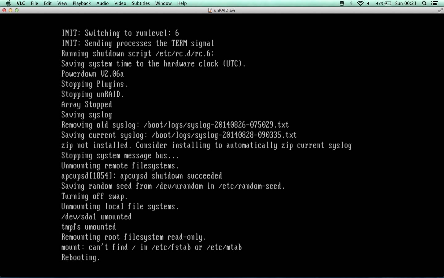

I have attached a screen grab as the system shuts down. I don't know if it helps WeeboTech.

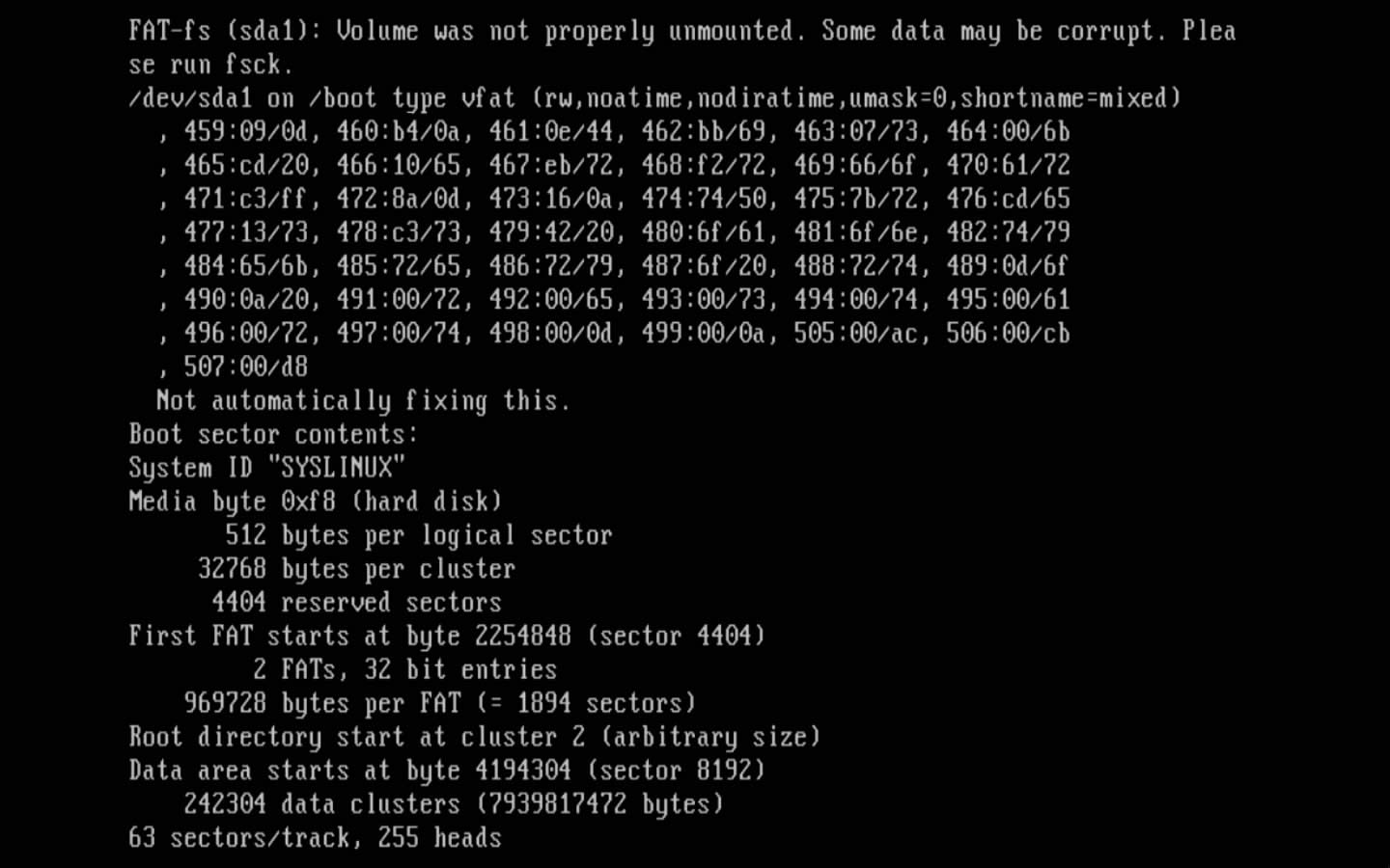

As soon as I run this it shows me the information in the image below.
I'm not sure what all those numbers are.
