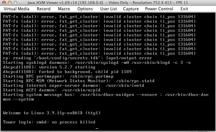

I was trying to copy about 100 GB files into my server and the system crashed.
So I had to reboot the server.
And now I getting the following:
    "Tower login: smbd: no process killed"
It seems that 100GB file-copying was too much for the server.
I can not even log on to the server.
Pressing "tab" or "del" key is not working either.
Any help would be appreciated!

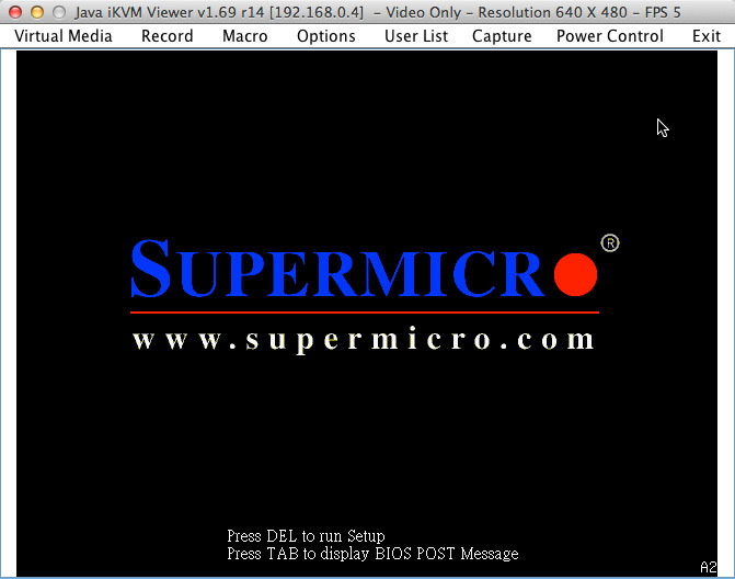

When I boot the  sever, I see the following:
  Press DEL to  run Setup
  Press TAB to display BIOS POST Message
  Press [Tab] to edit options
No response to any key pressed.
And after I received  "Tower login: smbd: no process killed",
there is no response when I type something.
How can I get out of this mess?
That last screenshot suggests you have got some sort of corruption on the USB stick.  You should connect it a PC/Mac to try and correct this.
I took the USB out but don't know how to correct this.
Do you know of any link to learn how to do this?
Thanks.
You just need to run checkdisk on it in a Windows machine. If you plug it in it will probably offer to fix it for you.
For Mac, I think you run Disk Utility on it.
Thank you so much.  It is working again.
