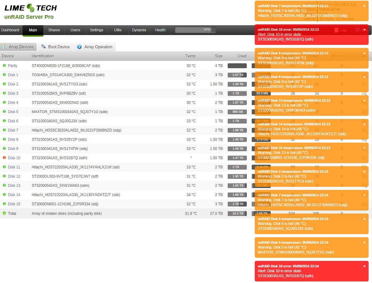

After a reboot 2 days ago it automatically started a parity check without my realizing it.  I usually put a desk fan on the enclosure when I choose to run a parity check b/c of heat, thus things overheated & locked-up.  The next day after a reboot disk10 shows red.  And now, in Dynamix gui, it keeps reporting drives overheating even though the drives are cold, and the devices gui shows low temps - see screenshot.

Thanks, I just adjusted the settings, but what was weird is as you can see in my screenshot, I was getting the temp warning for drives that weren't past that threshold.
