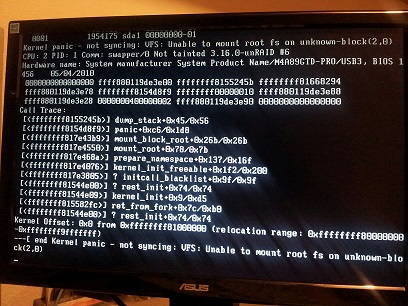

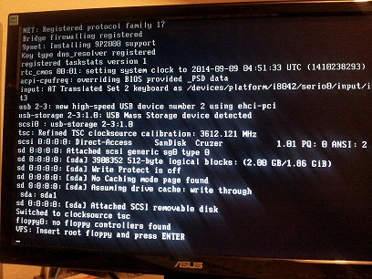

Still not working with beta9. Tried on a Supermicro motherboard and get the same result as the Asus. Attached some photos as there was no log to get. Thanks again for all your help! May have to hit up Tom for swapping this one out for another drive.

Just tried changing the speed and the modes. Still ends up locking up with the Kernel Panic. Still odd that it would work with 5.0.5 but not with beta's.
