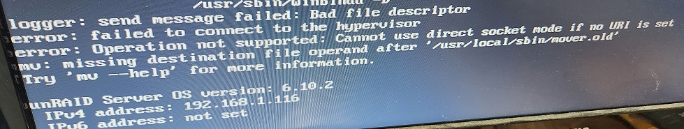

  3. I recently had a flash drive scare where I thought my original drive was finally going to die on me. I think it's over 10 years old at the point (4Gb HP). Watched Spaceinvader1's video and found the suggested Kingston and Samsung on Amazon, only to come here after I ordered and received those to see that they are probably counterfeit drives. So, I will be returning both per the suggestions of others. That led me on a search to find a backup for my original drive and I found some 16gb HP drives on sale at Office Depot/Max. The have a unique GUID and work with Unraid though I had to do a manual install. Also, the website and packaging says it's a 16gb drive, but it shows up in windows as 28.8. They are USB 2.0 drives which I know is prefered. https://www.officedepot.com/a/products/5892874/HP-v150w-USB-20-Flash-Drive/ I am going to boot up one on my test server and see how long it lasts.
  4. I removed a few more plugins I was testing and also reverted my go file to like it was a new install and I am back up and running. Thank you to those that replied.
  5. Did some additional searching and reading on the cannot connect to the hypervisor. Turns out the VM backup plugin I was testing is not supported anymore and when I removed that .plg from the plugins folder that went away. Still cannot login to the GUI, even in safe mode which is weird as I do not have automatic startup enabled so docker and the VM's won't start at boot. Assuming it must be another plugin now? I did wipe my thumb drive and put a fresh install on that. Boots up quickly and can login to the GUI so I know it's not the MB, processor or video card. I did not have drives connected on the fresh install, but that shouldn't matter. Any more suggestions on what to remove from my startup to get back into the GUI would be appreciated!

  7. LSI in IT mode. I have had zero issues with them and years ago had two of them fully populated. With the larger drive sizes now I am down to 11ish drives.
