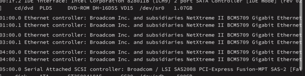

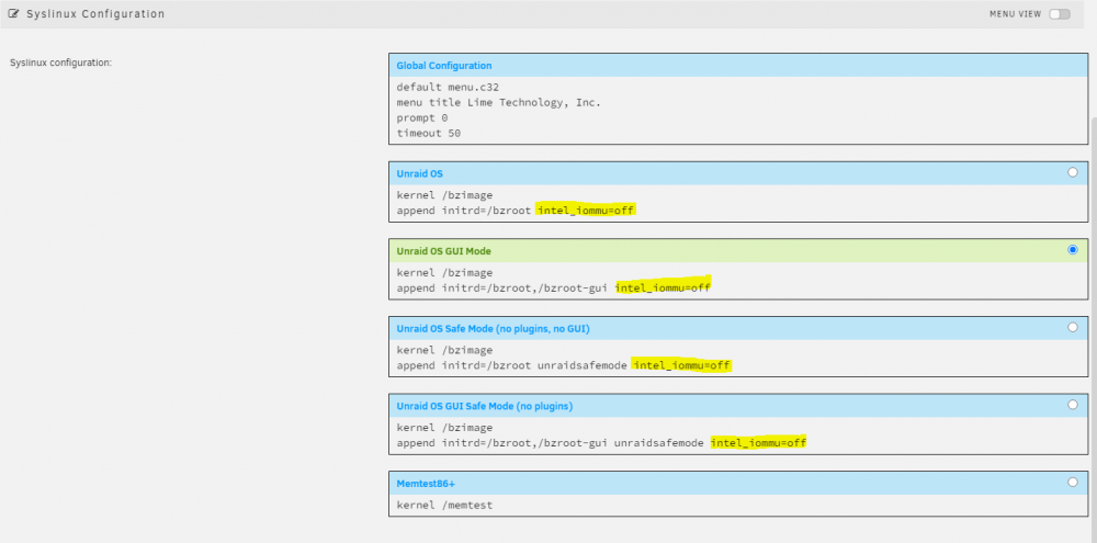

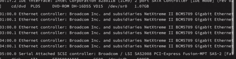

How does this affect those of us with Dells turning iommu=on?
Post says “Broadcom NetXtreme Gigabit Ethernet NIC (note: there may be others).” are affected but what about “NetXtreme II”? Would they be affected?
See attached pic.
Edited by blaine07
See attached pic.
Does it use 'tg3' driver?
No, it appears not
“lsmod | grep tg3” says no
but having changed the IOMMU thing how do you recommend I proceed? Leave or remove that startup change? If it turns Intel IOMMU on but the changes turn it off will their be conflict?
see attached pic
Edited by blaine07
By "change" if you mean code added in this release to blacklist 'tg3' - it does not enable/disable Intel IOMMU.  It detects if Intel VT-d is enabled, and if so, auto-blacklists 'tg3' - that' s it.
I think the issue you are referring to is unrelated.  Can't remember atm, but isn't this issue with older Dell's? Older platforms, such as GEN8 Microservers have buggy bios which does not reset/virtualization correctly and manufacturers have no appetite to go fix.
Sorry, on the tg3 I didn’t really understand. Ultimately just trying to determine it is safe for me to upgrade. Can rollback if necessary so no harm no foul.
Yes, the BZROOTIMG thing is related to older-ish Dells. First I’ve heard about not resetting virtualization correctly though so not sure there?? 🤔
Thank you for the insight; thank you for your time to help me understand a little bit here.
Different driver:
01:00.0 Ethernet controller [0200]: Broadcom Inc. and subsidiaries NetXtreme II BCM5709 Gigabit Ethernet [14e4:1639] (rev 20)
    DeviceName: Embedded NIC 1
    Subsystem: Dell PowerEdge T610 BCM5709 Gigabit Ethernet [1028:0237]
    Kernel driver in use: bnx2
    Kernel modules: bnx2
As far as we know, not affected, so far all affected servers I found, about 10 in total, were using a NIC with the tg3 driver and that appears to be the only thing they had in common.

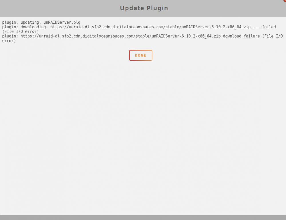

I am getting following error when update from 6.9.2
plugin: updating: unRAIDServer.plg
plugin: downloading: https://unraid-dl.sfo2.cdn.digitaloceanspaces.com/stable/unRAIDServer-6.10.2-x86_64.zip ... failed (Network failure)
plugin: https://unraid-dl.sfo2.cdn.digitaloceanspaces.com/stable/unRAIDServer-6.10.2-x86_64.zip download failure (Network failure)
Network failure *implies* an issue with your configuration (wrong DNS addresses / gateway) or the date & time completely wrong etc.
