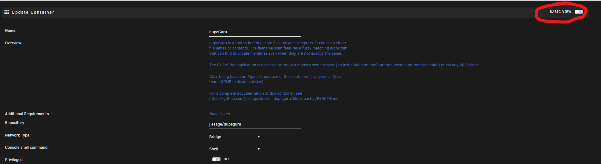

When editing a docker container, Unraid does not remember that I picked the "Advanced View" anymore.
Instead it always shows me the basic view.
Is this intentional?
It's a bit cumbersome, having to click this every time, as I regularily use/modify the fields that are hidden in basic view.
Yes, configuration is always opened in basic mode.
Ah I realized that template authoring mode got disabled for some reason.
Probably had to do with me restoring a bunch of settiings from backup due to fixing another issue.
Thanks for the replay nonetheless!
