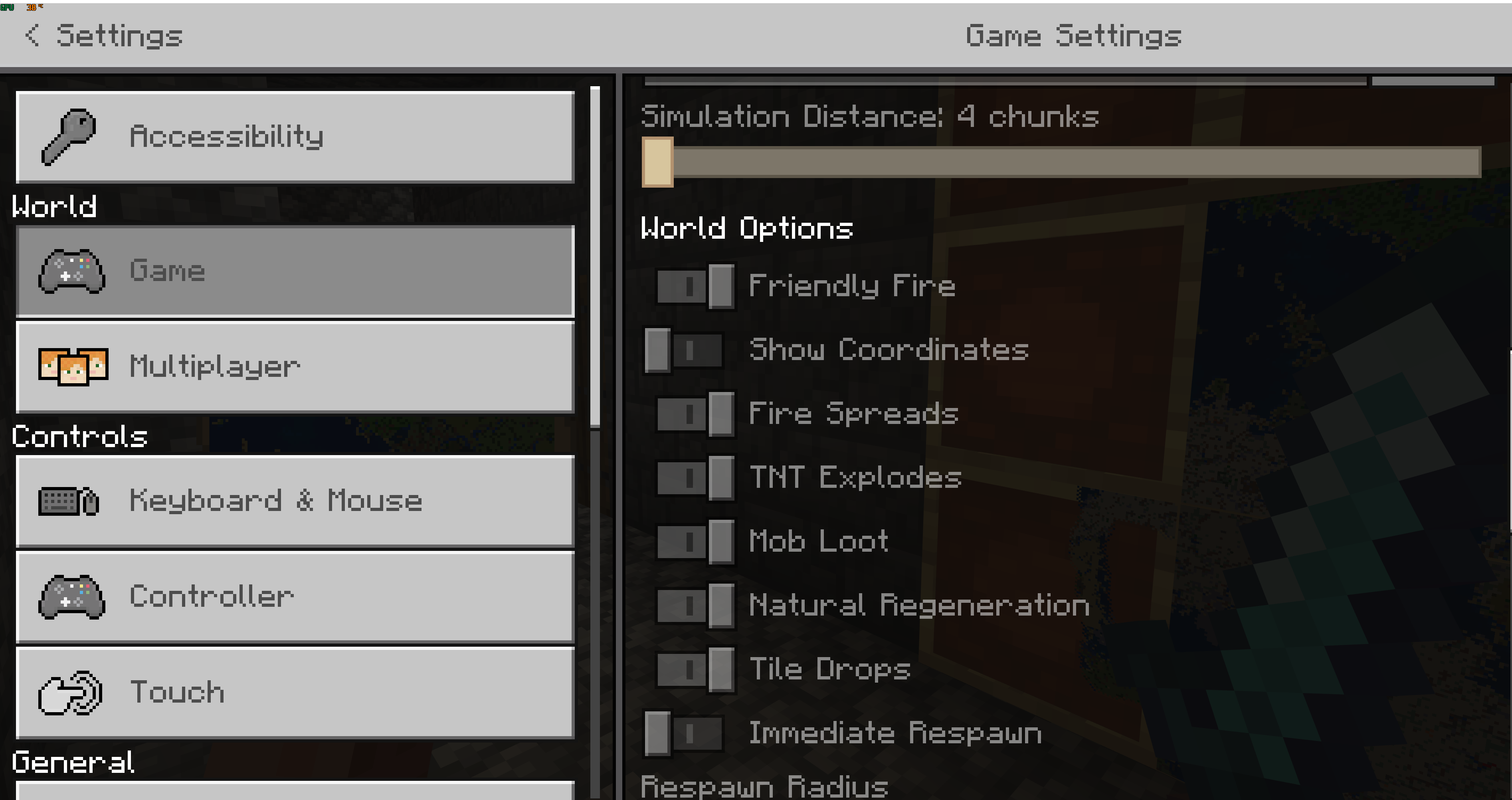

  6. Does anyone know if an Intel 660p would be okay with being run in the cache pool? I know hardware passthrough doesn't work, I am curious, if I can buy a few of these on the cheap, and replace them with my exist 500GB sata ssds for my cache pool. I never tested that when I had the 660p originally, before I returned it and got a samsung drive.
  7. It's okay, I know sometimes it's added because of editors, which is why I asked. No harm, no foul! You are correct, it does force a return character. I gave up testing yesterday afternoon when I noticed that it was not returning, and had to do other things. In the event that this ever needs to be question again, here is the command I used (With minecraftserver, being the name of my docker) docker exec -u nobody -i minecraftserver screen -S minecraft -p 0 -X stuff "gamerule showcoordinates true"^M I noticed that it the ^M was inside the quotes, like the documents said it should be, it wouldn't work. However, on the outside it does work. OH THANK GOD! I am so rusty on any sort of command line interface, I just installed Ubuntu in a VM and will start re-exploring programming and CLI. You, @binhex, are a god among men, for all the dockers you do. Thank you for all the help you have provided me, and the community at large.
  8. Thanks! I didn’t see that page before. Got it working now. But sorry to be such a bother, I did notice that when I restart the container it loses the change for showcoordinates. I tried to follow the section later on where it says that you can run a command on a Schedule via shell, by running this command in a script. docker exec -u nobody -i <name of container> screen -S minecraft -p 0 -X stuff "<command to execute>^M" I changed the name to my container name, and I added the “gamerule showcoordinates true” and left the ^M. However when I ran the script and logged in it didn’t make the change. Should I remove the ^M? Or is there a special way I need to format the script to get it to log into the docker from UserScripts?
