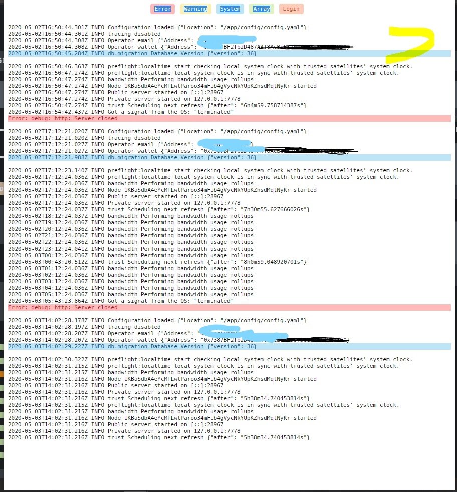

First of all thank you for this container,
However, my container does not come online.
I created my identity and adjusted everything in the container settings.
Hope you have an idea.
Regards Maggi

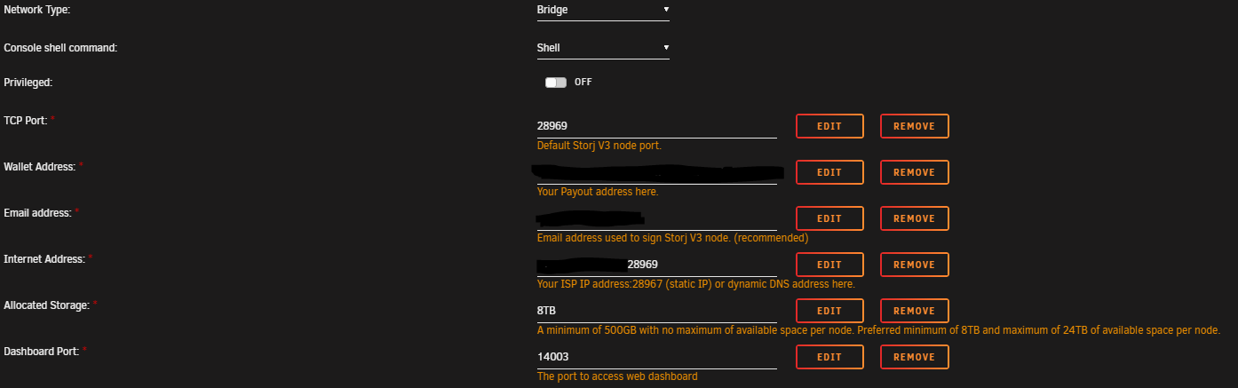

Regards Maggi
Hi Maggi,
Could you post your logs output and a screenshot of your config page for the docker or the run command that appears when you start it.
349012932_StorjDockerLog_LI(2).thumb.jpg.9357ba24683c679faa45bd46323b82e1.jpgThis my Log.

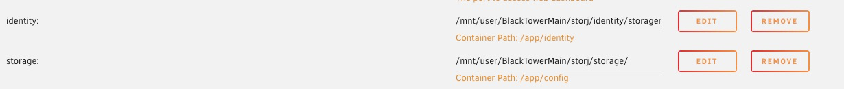

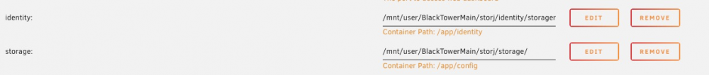

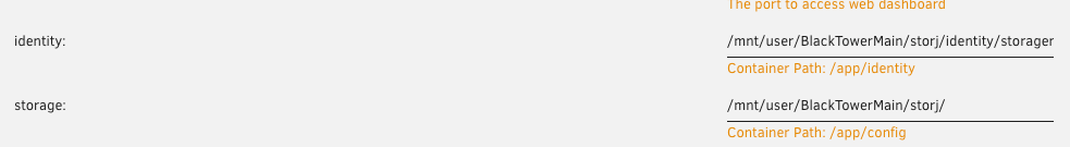

Mine doesn't work either. One diff: I'm pulling latest vs. beta
This is the error after attempting to add the container:
-v '/mnt/user/BlackTowerMain/storj/identity/storagenode/':'/app/identity/':'rw' -v '/mnt/user/BlackTowerMain/storj/':'/app/config/':'rw' --mount type=bind,source="/mnt/user/[your identity directory]/identity/storagenode/",destination=/app/identity --mount type=bind,source="/mnt/user/[your storage directory]/",destination=/app/config 'storjlabs/storagenode:latest'
/usr/bin/docker: Error response from daemon: invalid mount config for type "bind": bind source path does not exist: /mnt/user/[your identity directory]/identity/storagenode/.
Something to do with [your identity directory] perhaps?
since it doesn't fit: /mnt/user/BlackTowerMain/storj/identity/storagenode/
Files are there :
root@BlackTower:/mnt/user/BlackTowerMain/storj/identity/storagenode# ls
ca.xxxxxx.cert  ca.cert  ca.key  identity.xxx.cert  identity.cert  identity.key
root@BlackTower:/mnt/user/BlackTowerMain/storj# ls
config.yaml  identity/  revocations.db  run\ commands  storage/  trust-cache.json
Kinda out of ideas for the template. Next I guess I'll just do it via CLI

Sorry for the late reply. You needed to add the storage via the --mount flag in the extra parameters field as described in the documentation and docker description. That's why you were getting the error.
Edited by MrChunky
3 hours ago, MrChunky said:
Sorry for the late reply. You needed to add thee storage via the --mount flag in the extra parameters feald as described in the documentation and docker description. That's why you were getting the error.
There's nothing labeled as 'Extra Parameters' anywhere. Perhaps can you expand on that with a screenshot?

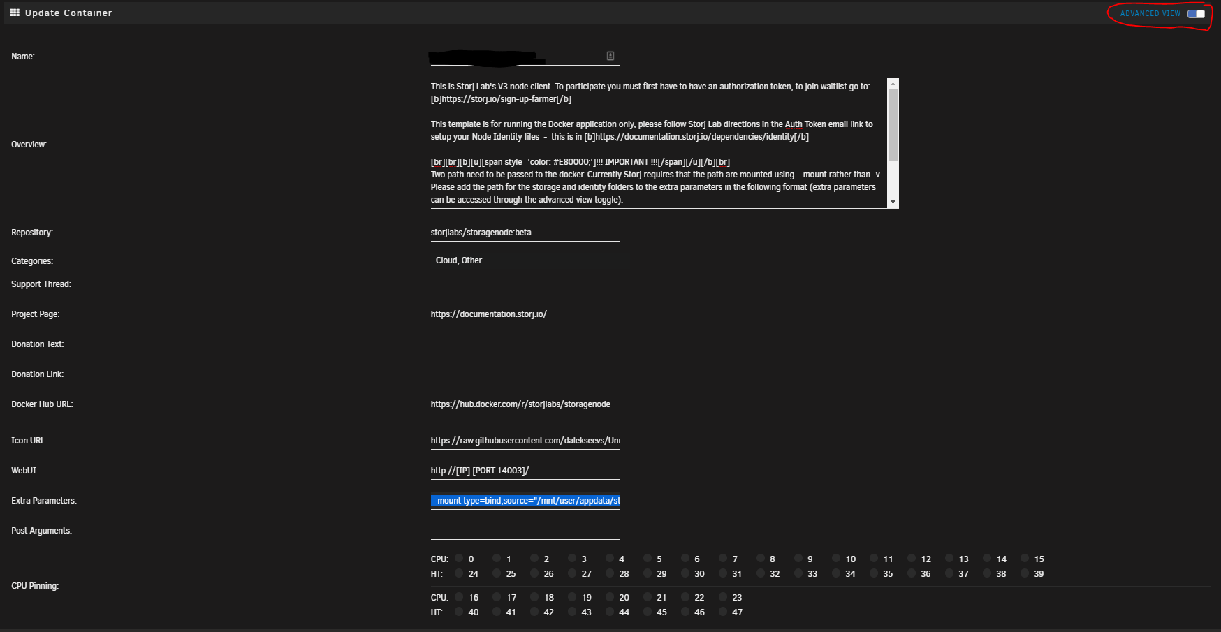

Sure, here you go. In the top right you need to toggle the Advanced View to see the extra parameters.
Edited by MrChunky
Ah! Thank you.
Now to figure out why the terminal window keeps closing over and over...
I'm missing something...Here's the template Command from your template:
/usr/local/emhttp/plugins/dynamix.docker.manager/scripts/docker run -d --name='storagenode2' --net='bridge' -e TZ="America/Chicago" -e HOST_OS="Unraid" -e 'WALLET'='0x111111111' -e 'EMAIL'='[email protected]' -e 'ADDRESS'='xxxx.xxx.xxx:28967' -e 'BANDWIDTH'='100000TB' -e 'STORAGE'='2200GB' -p '28967:28967/tcp' -p '14002:14002/tcp' -v '/mnt/user/storjnode2/identity/':'/app/identity \':'rw' -v '/mnt/user/storjnode2/':'/app/config \':'rw' --mount type=bind,source="/mnt/user/storjnode2/identity/",destination=/app/identity \ --mount type=bind,source="/mnt/user/storjnode2/",destination=/app/config \ 'storjlabs/storagenode:latest'
/usr/bin/docker: invalid reference format.
See '/usr/bin/docker run --help'.
I removed the -v flags from the template as those are deprecated.
Now the template generates:
root@localhost:# /usr/local/emhttp/plugins/dynamix.docker.manager/scripts/docker run -d --name='storagenode2' --net='bridge' -e TZ="America/Chicago" -e HOST_OS="Unraid" -e 'WALLET'='0x123456789' -e 'EMAIL'='[email protected]' -e 'ADDRESS'='dummy.ddns.net:28967' -e 'BANDWIDTH'='100000TB' -e 'STORAGE'='2200GB' -p '28967:28967/tcp' -p '14002:14002/tcp' --mount type=bind,source="/mnt/user/storjnode2/identity/",destination=/app/identity \ --mount type=bind,source="/mnt/user/storjnode2/",destination=/app/config \ 'storjlabs/storagenode:latest'
Can you post your command output @MrChunky or tell me the next step?
At any rate, the template needs updating to remove -v generation.

In your case you have trailing backslashes: " \ " after the mount commands that I don't think should be there. When you paste the mount commands into the extra parameters, they should look like this:
--mount type=bind,source="/mnt/user/appdata/storj_cert/identity/storagenode/",destination=/app/identity  --mount type=bind,source="/mnt/user/storj/",destination=/app/config
The docker tag is latest, mine is beta. In addition, make sure the mount command for the identity folder should point directly to the folder with the certificates, and not a level above.
Edited by MrChunky
@MrChunky The trailing backslashes are from the official storj guide at https://documentation.storj.io/setup/cli/storage-node
And when I paste my command like they do in the terminal window they work and the node starts and comes online. So maybe the script is munging it because of the trailing backslash?
My command: (obviously this is a second node on a diff port but it works so that's fine)

The docker run format that you are using here is different then the xml format Unraid docker templates are using. You should remove the backslashes in the template.
Edited by MrChunky
Ok that was the last issue. Node is started and pulling/pushing data per the logs.
Thanks @MrChunky. The only things I'd suggest on the template are:
  • removing the generation of the deprecated -v flags
  • help note about no trailing slashes for the mounts since the shell command needs those so that confused me...maybe others
  • help note about selecting 'advanced view'
Thanks again.
No Problem.
  • I don't think the -v flags are there normally, at least when I pull the template they are not there.
  • Will do.
  • Already in the description.
Edited by MrChunky

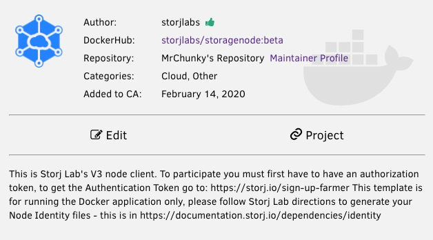

I believe it's this portion of the template that generates the -v flags @MrChunky This part certainly isn't needed in the template since it's passed via --mount anyway.
These two variables are not a part of the template I am maintaining. Here is the template XML from which it is generated. there are no -v fields.
Edited by MrChunky
@MrChunky Hmm.
This template has the same Overview text and icon URL so I wonder how it's different.
I got it from the Apps tab on Unraid:
Is there a newer source?
For other migrating. Slightly confusing, make sure you use the correct path for storage, i.e., without '/storage' at the end per:
https://documentation.storj.io/resources/faq/migrate-my-node
"Please, note - we intentionally specified/mnt/storj2/storagenode-new as the data source in the --mount parameter and not /mnt/storj2/storagenode-new/storage because the storagenode docker container will add a subfolder called storage to the path automatically. So please, make sure that your data folder contains a storage subfolder with all the data inside (blobs folder, database files, etc.), otherwise the node will start from scratch since it can't find the data in the right subfolder and will be disqualified in a few hours."
