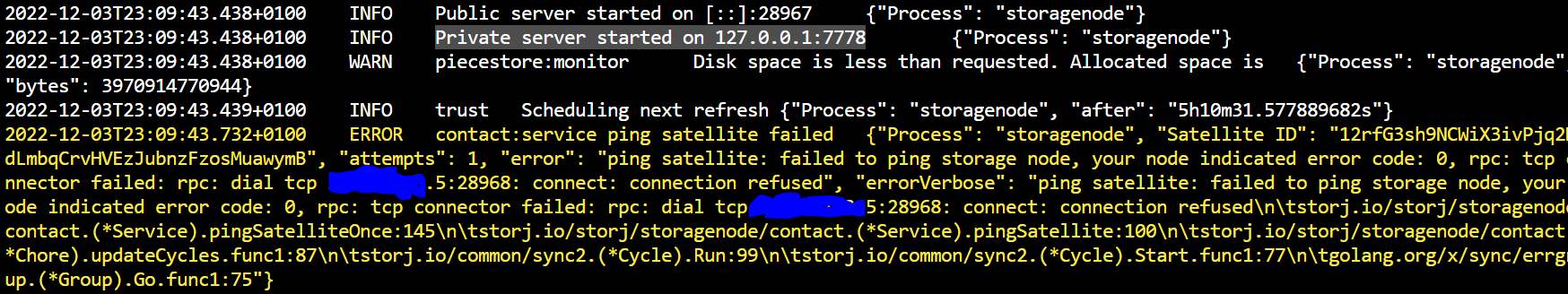

Hi
I have the node running successfully with a 4TB hard drive via Unassined Devices.
Now I would like to set up a 2nd identical Docker node with a 2nd hard drive.
Unfortunately, I can't set up the docker again.
Can anyone give me a hint?

Thanks for the tip that worked.
I change all ports and now create a new identity.
Apparently there is no problem with the same IP since a node uses a maximum of 10% of your line (somehow I understood it that way) so several nodes make more sense than a share (2 hard drives to connect with only one node)
So the 2nd Docker is created.
I have changed all ports but unfortunately it doesn't start because there are always errors connecting to the satellites (I see in the log) I can't connect to the web server either.
I assume so because I can't change the private server port.
Anyone have any idea?
Edited by Lucas Mietke
Says right there "public server started on 28967", which is the default port so thats the port your first install is using.  You need to set it up on a different public port and forward that port in your router to your second container.
