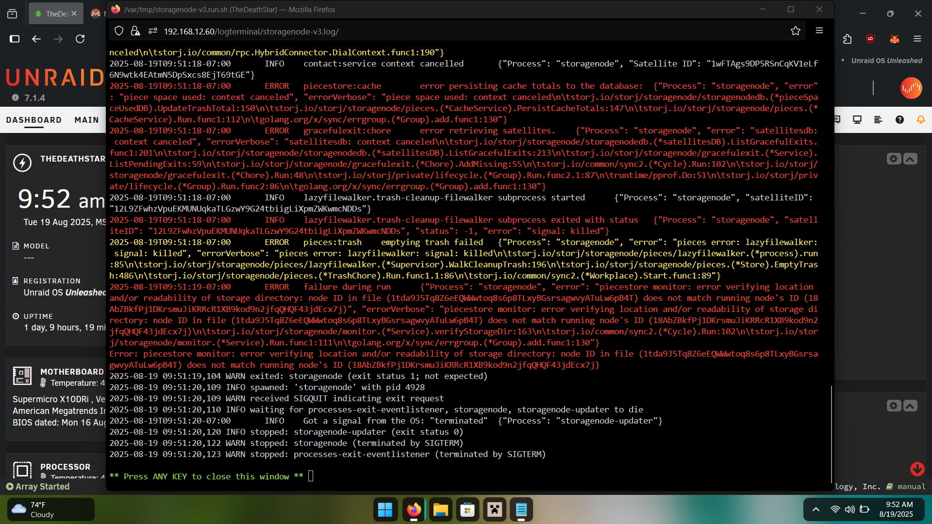

I have no idea what I'm doing. I have tried to get this up and for a couple of days now. If someone can tell me what I should do next that would be amazing!
