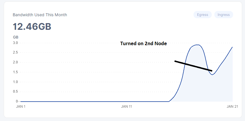

I can confirm, when I started my second node, my ingress on 1st node slowed, I do not know if it slowed my vet time. Do you know if I can check number of passed audits? I just see 100% not the actual count.
