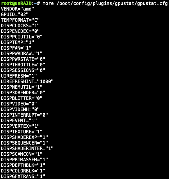

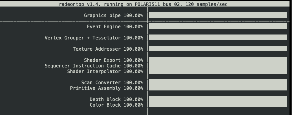

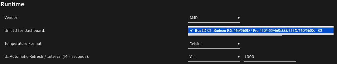

  7. Hi, trying my best to figure this out, but finally deciding to post here. Still occurring in 6.10.2. I have a pretty old Supermicro X8 with an AMD RX 560 installed. I have radeontop installed, as well as this plugin. I'm able to pass through the card to a Windows VM and use it fine. However, inside Unraid (both via this plugin's dashboard and radeontop in console) show 100% usage across the board. Nothing I'm aware of is using the card, so I'm guessing it's not accurate. Posting some screenshots here of configs. My only clue is when running radeontop -d - -l 1 I get the following output: Failed to find DRM devices: error 2 (No such file or directory) Failed to open DRM node, no VRAM support. Dumping to -, line limit 1. 1654535060.478295: bus 02, gpu 100.00%, ee 100.00%, vgt 100.00%, ta 100.00%, sx 100.00%, sh 100.00%, spi 100.00%, sc 100.00%, pa 100.00%, db 100.00%, cb 100.00% Any ideas?
