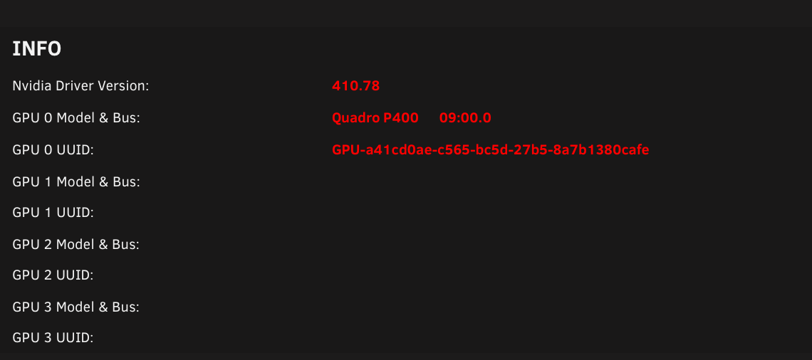

Having trouble with the runtime not working.
when i first installed the plugin docker was able to use the nvidia runtime after a restart of a plex container docker started throwing the unknown runtime error. i reinstalled the stock unraid...then reboot.... then reinstall nvidia build. same thing no nvidia runtime.
i am able to run nvidia-smi from unraids shell all is good there
/usr/bin/docker: Error response from daemon: Unknown runtime specified nvidia.
See '/usr/bin/docker run --help'.
The command failed.
  OK got it - i was able to run docker with the runtime from the shell then i removed the unraid template and used a new template from the community apps and unraid was then able to fire up the nvidia runtime. i then was able to successfully use the GPU for plex
