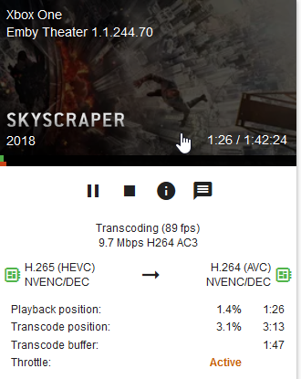

I personally have had a lifetime emby premiere that a paid for up front for about three years now, worth every penny in my opinion. It's been almost totally maintenance free for that whole period, it just works. i have typically 1 local and 4 remote clients connected every night.

I can thoroughly recommend Emby. Jellyfin is an alternative, but I wasn't too impressed with some of their behaviour initially so Emby gets my vote.
