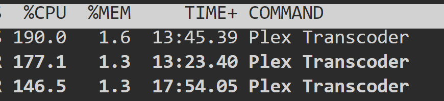

Any idea why this is happening? image.png.877f6eb48f6311bdc834a417267f1cff.png
This is only 1 stream transcoding and it is pegging my i5-8400
I turned off HW transcoding and now the same stream is running about 10% total cpu utilization with software transcoding.
Edited by Iceman
What Nvidia card are you using?
Sent from my Mi A1 using Tapatalk
Evga 1060 3gb
Showing as a P106 gpu
Edited by Iceman

Evga 1060 3gb
OK, you need to post some more details, Plex docker run command and some screenshots of the relevant Plex config pages.
