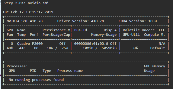

On 2/10/2019 at 1:04 PM, michaelfjsmith2 said:
Hello,

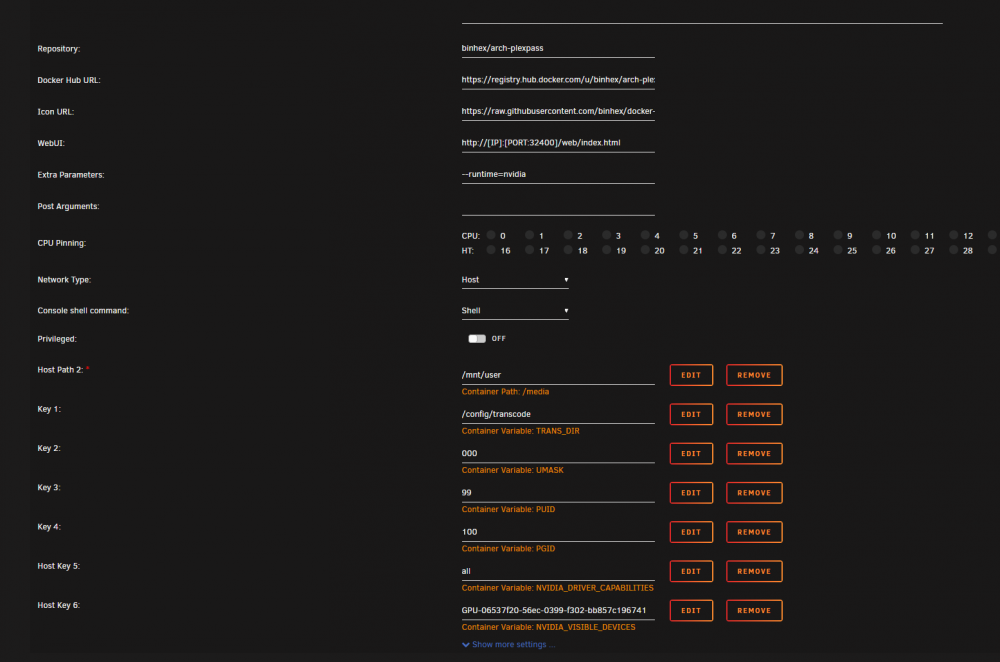

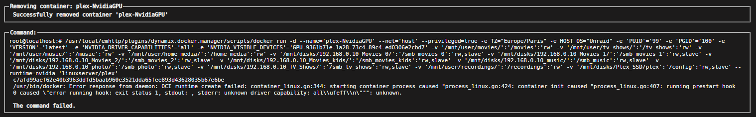

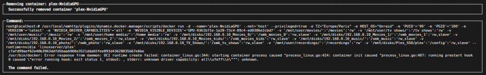

i am having an issue with adding the above instructions to an existing and a new plex docker. i am able to identify my GPU in the Nvidia Sceen and get the GUID.
Unraid Version - 6.7.0-rc3 with Nvidia
GPU - Quadro P2000
Below shows my setup in the docker followed by the error code i get when trying to apply. Any help would be greatly appreciated.
I have the same issue, seems that it's not available in "nvidia-smi", I get "No devices were found".  Any chance you are running Unraid in a VM?  I'm running in Qemu on top of Proxmox.  Wondering if that's my issue.  I also have a P2000.
Got it working for anyone running Unraid on top of Qemu like Proxmox.  I had to download a bios for the P2000 and include in the proxmox config:

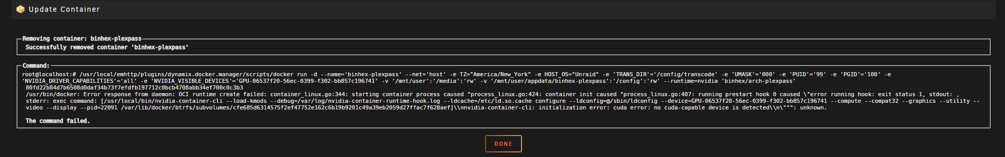

Unfortuanetly I get an error when trying to start the docker with the GPU (I have checked my input for any special hidden character )
Someone in this thread reported that he replaced his existing template with the standard template?
Don't know how to do this? only standard template I can select is not the one for Linuxserver Plex
So close now!!! ;-)
OK REMOVED everything and started over and I got it started but the looks like the docker selects the internal IGU before the Nividia GPU?
Do I need to change the Bios so that the external card is the primary for this to work?

Did you need the custom version of Plex that was built in that thread or does it work with any Plex now?  I'm running current binhex docker image.
Thanks!
