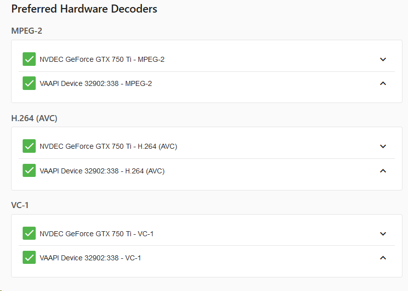

OK REMOVED everything and started over and I got it started but the looks like the docker selects the internal IGU before the Nividia GPU?
Do I need to change the Bios so that the external card is the primary for this to work?
All that nvidia-smi shows is that there are no active transcoding processes.   Not sure why you think it's showing a preference for the internal IGPU
Yes because Plex used my IGPU - it was showing HW transcoding in Plex and nothing in the above load for my P2000 Card.
i just changed my BIOS to have the PCi 1 as primary graphic and now the P2000 is encoding and doing all the work. Only downside is that I don’t have any console visible on my Unraid server anymore 😞

Plex keep switching back to the IGPU, even after setting the P2000 GPU as primary display in the bios?
Any "force full" way I can configure the Plex docker to only use the GPU?
I Have a Plex docker without the GPU configuration and here it selects the IGU and when doing the "watch nvidia-smi" I get an error like I should get
Running the other Plex Nvidia docker and executing the "watch nvidia-smi" it works and I get the picture below but no load on the GPU?
Looking in Plex I can see that it HW transcodes so it is using the IGPU again....
One thing come to think about it I did create a Video device in the org Docker that I build the new one on, but the below settings is not in any of the dockers so it can't be that can it?
Anywhere I can manually go through the file? or does anyone have any working XML template that I can try out?
When it works it is GREAT...
Remove the device mapping in the container settings and Plex won't see the igpu
I just did a total clean pull-install and set everything up from scratch!
(Also set the GPU as primary - Plex forum states that the primary display will be selected from Plex for HW transcoding)
And no matter what I do it does hw but I can not see any streams on the GPU?
image.png.f8ba0d5010e0438977f8b74333bc10d5.pngimage.png.fa383181623bf2a320f7c59e6c802aee.png
This is driving me nuts.... I have been trying so many different things i'm out of ideas?
UPDATE: I have noticed that after changing primary display (and moving the consol cable to the new primary)
the screen goes black after booting UnRAID? why wouldnt it just stay like normal blinking root?
does the new UnRAID build take ownership of the GPU after boot?
I also tried disabling the "PCIe ACS override" since I had this turned on in order to split my HW up into groups for the VM's didnt change a thing...
Edited by casperse
