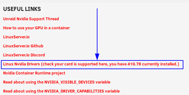

1 minute ago, CHBMB said:
I couldn't have made it any easier
Yes, but if you have not Nvidia for now, and just thinking of buying some?
Can still install the plugin, click the link and look, card capabilities vary, but we can only spoon feed so much......
Or Google?

ok, just updated my unraid, now i'm on 6.6.6. installed a plugin, clicked on "Linux nvidia drivers" link, and it took me to this page: https://www.nvidia.com/object/linux-amd64-display-archive.html
i selected a newest driver version, it list almost all available Nvidia cards. but still no info about particular card support for NVENC..
you should look rather in this? https://developer.nvidia.com/video-encode-decode-gpu-support-matrix
for example, GT1030 wont support NVENC, but supports NVDEC. do we nee both?
You need NVENC.
