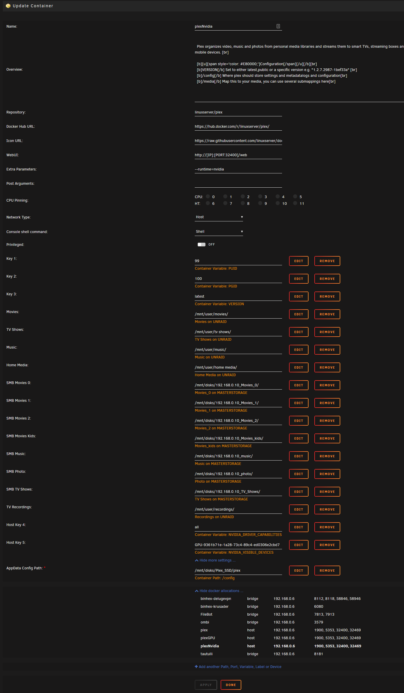

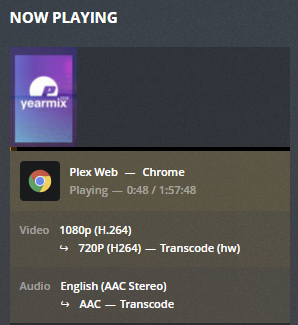

1 hour ago, casperse said:
I just did a total clean pull-install and set everything up from scratch!
(Also set the GPU as primary - Plex forum states that the primary display will be selected from Plex for HW transcoding)
And no matter what I do it does hw but I can not see any streams on the GPU?
image.png.f8ba0d5010e0438977f8b74333bc10d5.pngimage.png.fa383181623bf2a320f7c59e6c802aee.png
This is driving me nuts.... I have been trying so many different things i'm out of ideas?
UPDATE: I have noticed that after changing primary display (and moving the console cable to the new primary)
the screen goes black after booting UnRAID? why wouldn't it just stay like normal blinking root?
does the new UnRAID build take ownership of the GPU after boot?
I also tried disabling the "PCIe ACS override" since I had this turned on in order to split my HW up into groups for the VM's didn't change a thing...
Does any of the developers of this great achievement have any ideas as to how this could/can work on a board with a IGPU?
Some says that the P2000 doesn’t like to run headless - without a monitor attached so I also tried a DisplayPort dummy plug to try and fake out the adapter.
But sofar it just keep utilizing the IGPU, no matter what I do?
Please does anyone here have it working on a board with a IGPU? then please share your configuration ;-)
thanks
thanks
Did you remove the device mapping? Also make sure it is not in privileged mode. Both of those will let plex see the igpu. Without them, plex won't even know the igpu is there
Thanks @aptalcaThat was something I hadn't tried during my last 5 hours of troubleshooting :-)
thanks for your input! - Disabled privileged input didn't realize that this would make a difference
Unfortunately it doesn't seem to make a difference...
This is my configuration - made from scratch no copy so there shouldn't be any device mapping to the old IGPU
What about the console screen going blank after booting is this normal? - Im afraid some other thing is taking ownership of the GPU?

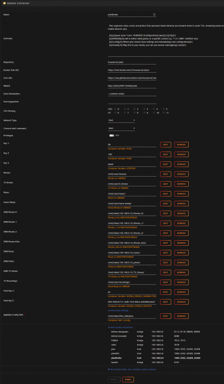

8 minutes ago, casperse said:
Thanks @aptalcaThat was something I hadn't tried during my last 5 hours of troubleshooting 🙂

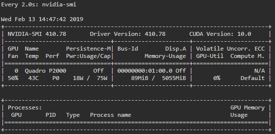

If you want to be sure it's not using the iGPU, remove the modprobe i915 from your go file. But with priviliged off and no /dev/dri passed through, it's using your gpu.
Even though nvidia-smi doesn't show anything doesn't mean it's not working. Might be a bug with it and your card. Which card do you have?

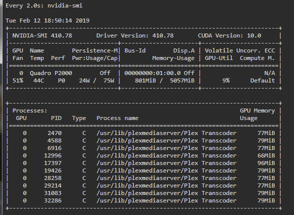

I know the card works because it actually did work for a whole glorious hour yesterday at 18:50 I got 10 streams with like only 9-10% load
it's a Quadro P2000 everyone wrote that this was the one to get...
and then after a reboot it just stopped working today?
Since then I have tried to think what could have changed? (The privileged setting was one thing!)

Okay removed the modprobe it and did at reboot and now I have my console screen back on the primary P2000 card. 😊
I then started to play files and many files and I still couldn't see any stream on the "watch nvidia-smi" output console
But then I noticed that the load went up, and so is the memory so could it just be an error on the output screen?
Yes, probably.  I see the same with my GTX 1060.  When there is usage, the processes are not listed, but when not in use, it says something like there is no process using the card.
Ok that could indicate that there is another problem, I just closed my firefox running 6 streams and they all continued to run on Plex?
I had to reboot them to kill the streams, even tautulli and the Plex dasboard couldnt kill them! only a reboot
Strange.  In my case, they die themselves after a few seconds (less than 30 usually).
