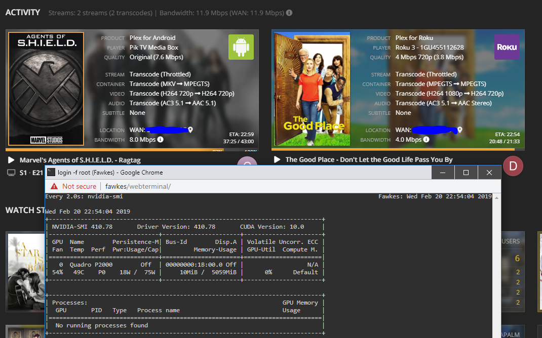

Out of curiosity, today I had 2 transcoded streams going, but none of Tautulli, Plex, nor nvidia-smi showed that hardware acceleration was being used. Does this indication go away if the transcoder has completely transcoded the file and the stream is playing off the completed transcode? Transcoder progress showed 100% for both of these streams.
From your screenshot it doesn't look like Plex is using hardware transcoding.
