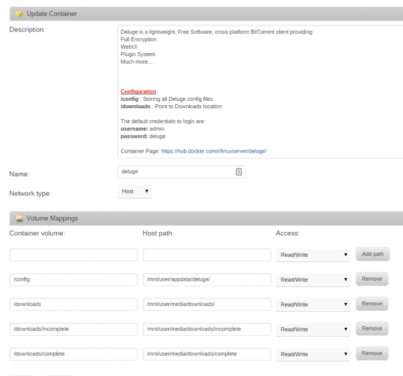

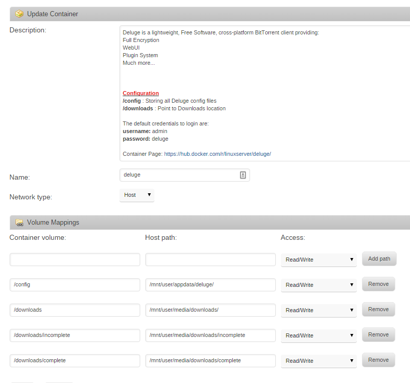

  13. Oh, I was referencing the second reply to this thread! Thought that was somehow related... I'll post tonight when I get home and can post better screenshots.
  14. My docker config is attached. The config is in /mnt/user/appdata.
