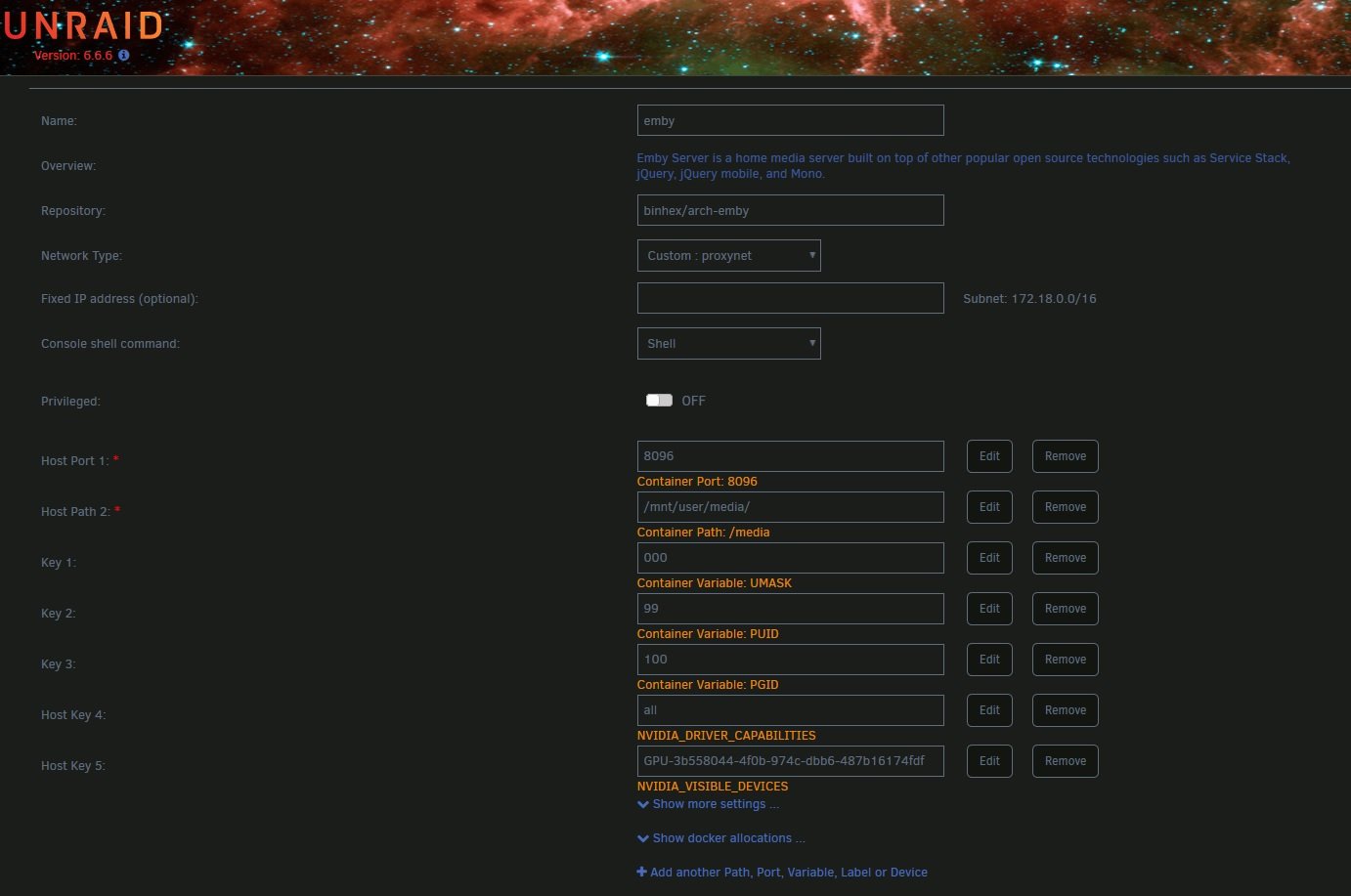

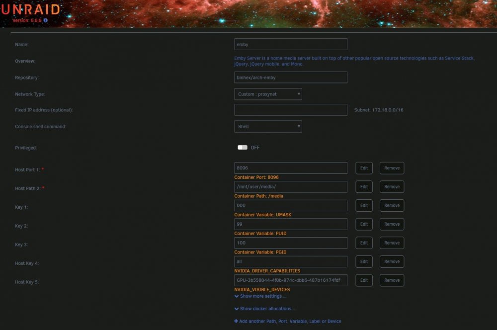

2 hours ago, Letete said:
Great work. Too bad i can get it too work i docker.
I think I need help. I have a try PCIe ACS override but no luck.
Error log in binhex-emby:
Error VaapiCodecInfoProvider: ProcessRun 'ffdetect_vaencdec' Process error:
Error VaapiCodecInfoProvider: ProcessRun 'ffdetect_vaencdec': Error starting Ffdetect
Error VaapiCodecInfoProvider: Error running ffdetect for vaencdec - args: -hide_banner -show_program_version -loglevel 0 -show_error -show_log 48 -print_format json vaencdec
sdg-diagnostics-20190221-1451.zip

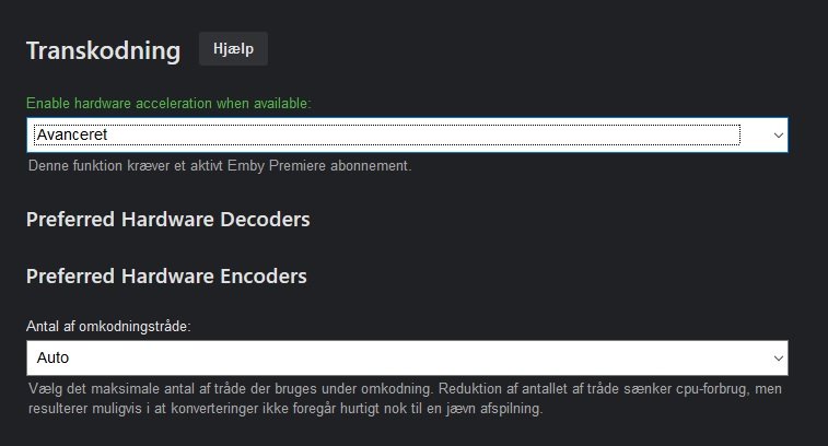

Your screenshot from Emby clearly says you need an active Emby premier subscription for hardware acceleration to work.
saarg
I have active Emby premier subscription. I have tried to add the gfx in a VM and there were no problems
Edited by Letete

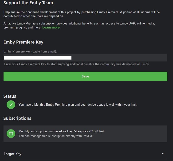

saarg
Your screenshot clearly said that you did not have a Emby premier subscription. Yes I can read Danish.
Did you restart emby after adding the subscription?
I don't see --runtime=nvidia added in the extra parameters field.
Edited by saarg

saarg
--runtime=nvidia is add to extraparameters field. forgot to show Advanced View in the screenshot
1 hour ago, Letete said:
saarg
The vaapi errors might have something to do with it. Might be something in binhexs emby container. You don't pass through an igpu?
Can you test installing the original emby container and see if that works?

@saarg
It was the Binhex-emby container there was the problem.
Thx for the help.
