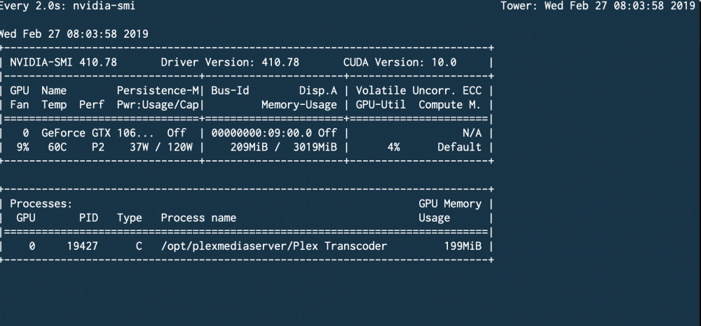

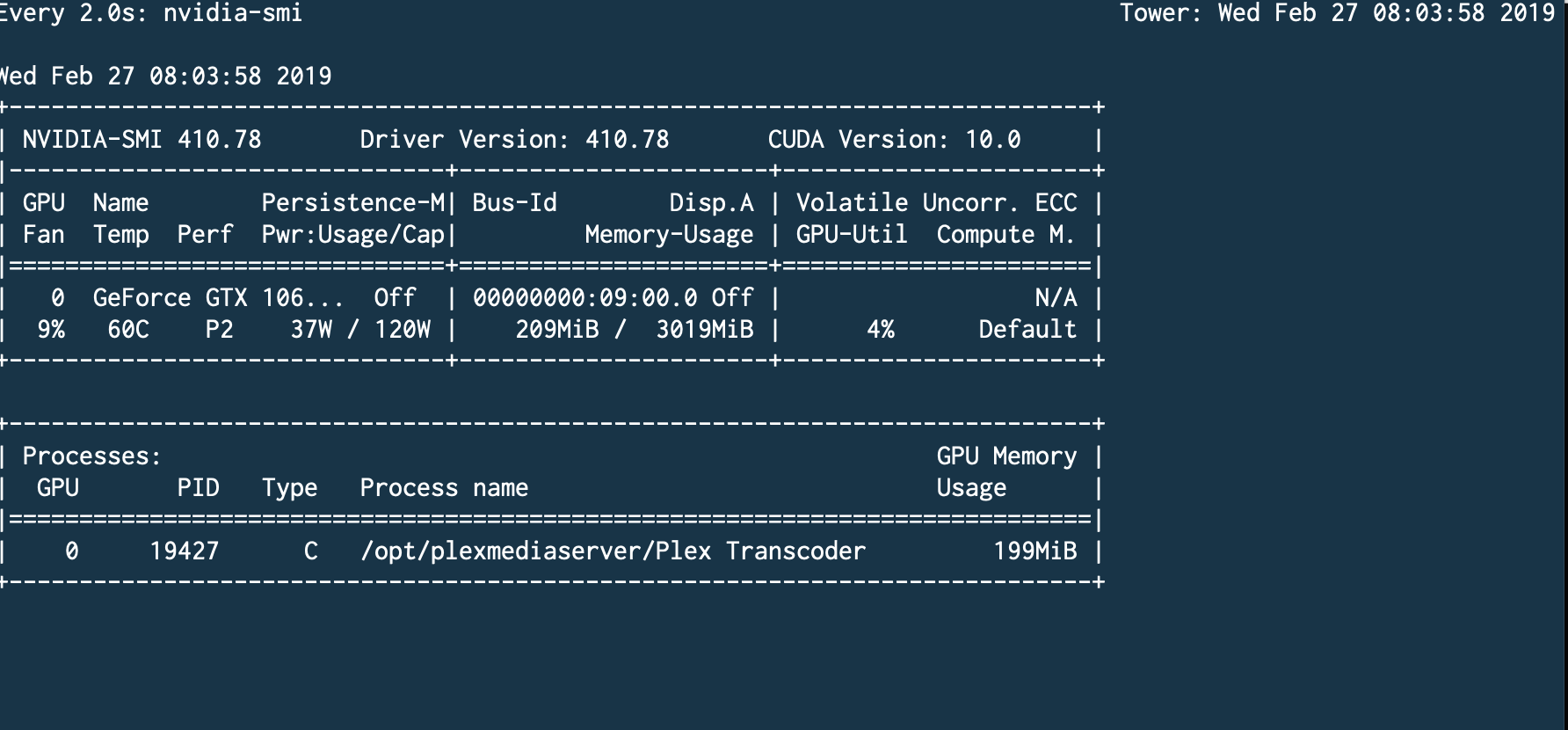

5 minutes ago, Blumpkin said:
I have a 1060 and installed the plugin. Using the nvidia-smi command, I can see that it is hw transcoding a 4k video in plex, but CPU usage is still really high.  It is transcoding from 4k HDR to 1080p. Any thoughts?
Plex is still using the CPU for decoding.
Look at htop and you will probably see Plex Transcoder there too
Plex by default currently only hardware encodes, not decodes.  Have you patched Plex to hardware decode?  If so, the CPU usage could be the audio stream.  Somebody else may know more - I'm only going by info in this thread.
Run the decoder patch posted a few pages back. If done correctly, you should be seeing close to 1gb of usage per stream on Nvidia-smi.

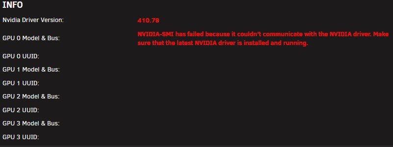

6 hours ago, saarg said:
Can you post a screenshot of the plugin page?
Attached is a screen shot. I also found this in the logs. I am thinking I fell victim to a fake GTX 1050TI.....
Feb 26 19:25:38 NASBOX kernel: nvidia-nvlink: Nvlink Core is being initialized, major device number 246
Feb 26 19:25:38 NASBOX kernel: nvidia 0000:03:00.0: vgaarb: changed VGA decodes: olddecodes=none,decodes=none:owns=io+mem
Feb 26 19:25:38 NASBOX kernel: NVRM: The NVIDIA GPU 0000:03:00.0 (PCI ID: 10de:1c82)
Feb 26 19:25:38 NASBOX kernel: NVRM: installed in this system is not supported by the
Feb 26 19:25:38 NASBOX kernel: NVRM: NVIDIA 410.78 driver release.
Feb 26 19:25:38 NASBOX kernel: NVRM: Please see 'Appendix A - Supported NVIDIA GPU Products'
Feb 26 19:25:38 NASBOX kernel: NVRM: in this release's README, available on the operating system
Feb 26 19:25:38 NASBOX kernel: NVRM: specific graphics driver download page at www.nvidia.com.
Feb 26 19:25:38 NASBOX kernel: nvidia: probe of 0000:03:00.0 failed with error -1
Feb 26 19:25:38 NASBOX kernel: NVRM: The NVIDIA probe routine failed for 1 device(s).
Feb 26 19:25:38 NASBOX kernel: NVRM: None of the NVIDIA graphics adapters were initialized!
Feb 26 19:25:38 NASBOX kernel: nvidia-nvlink: Unregistered the Nvlink Core, major device number 246
Didn't know there were fake ones around. Could it be either a hardware incompability or bad card?
It also depends on where you bought the card.
Yea after having these issues I started doing some research and I'm fairly certain it is a fake card. Should have figured so based on the price.
Anyway I've tried a different 1050ti and it's recognized. Now to pass it to plex and do some testing!
