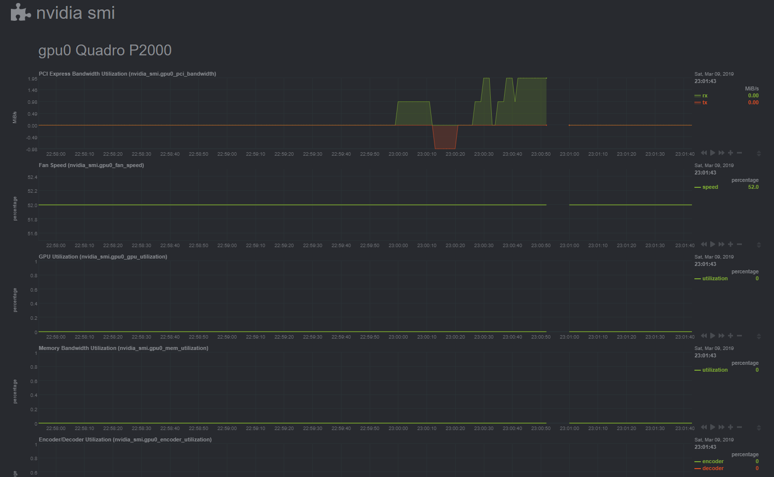

Where in Netdata are you finding this graph? I've got it passed through and can see nvidia-smi from the NetData console but cannot find this chart. I've run the command in the container etc. so I think I should be set but cannot find data in the interface.
Use the script posted here and it will show up in Netdata. https://forums.unraid.net/topic/77813-plugin-linuxserverio-unraid-nvidia/?do=findComment&comment=728822

On 3/10/2019 at 6:06 AM, Xaero said:
Got this working in netdata!
So, don't worry about grabbing a special version, the version from Community Apps is fine.
Steps to reproduce:
Grab the docker from Community Apps.
During the initial container install switch to advanced view, and add --runtime=nvidia to the end of the list.
Add a new variable "NVIDIA_VISIBLE_DEVICES" with the value set to "all"
Click done, and let the docker install.
Open a console for the docker.
echo "nvidia_smi: yes" >> /etc/netdata/python.d.conf
Restart the docker.
Enjoy.
Just a quick note on this (which always trips me up) - if you're not getting it to work, manually type the commands into the docker template rather than copy/paste.  That gets me every time!
And to clarify -  "switch to advanced view, and add --runtime=nvidia to the end of the list" means add it to the end of the "Extra Parameters" field.
Got mine working now, and just spent 10 minutes wondering why all graphs were flat.  Then realised that I was using Direct Play in Plex.  D'OH!
