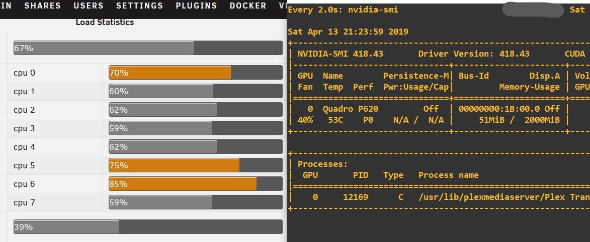

I have a similar problem with High CPU usage. Ive enabled NDEC via the script. I can play a movie on plex and can see the processes on nvidia-smi. I can also confirm decoding via "nvidia-smi dmon -s u2.  Once its throttled I see very low CPU (3-4%).  Everything is perfect as long as I dont FF or RW the movie on plex. For every time I scroll on the time-bar of the movie on the plex app. CPU usage goes up as if it was a new software transcode.. after 4 or 5 times my CPU is at 100%.  Im using a Quadro P4000.
Also the Processes on nvidia-smi dont die after I stop the movie.
Using linuxserver plex docker

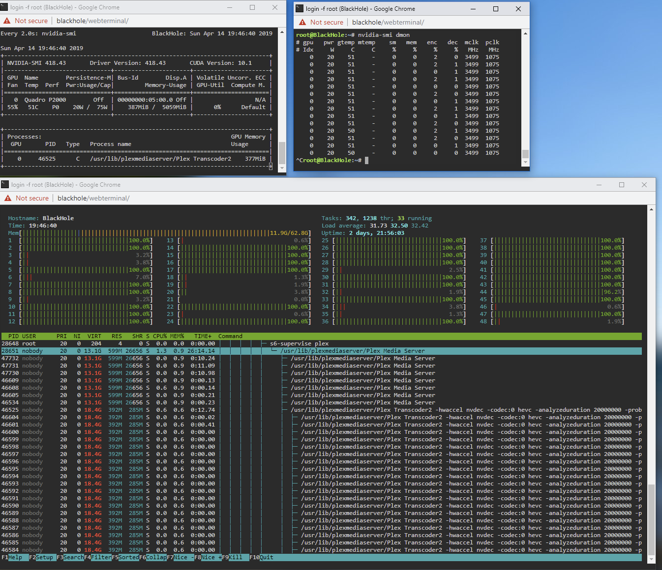

Second, when watching nvidia-smi dmon -s u; It is important to note that there are separate columns for different usage metrics. For example, there is a column for the gpu core itself, the "streaming multiprocessor" (sm), memory, the nvenc and nvdec pipes. The nvenc column only refers to encoding, while the nvdec column only refers to decoding.
From there, keep in mind that with the latest version of the script and mpeg4 avi media, the card will only be used for encoding, as the decoder vomits on that particular type of media.
I am using a Quadro P2000, for reference which is very closely related to your P4000. I will note that currently I have abysmal 4k transcoding performance for some unknown reason.
For example, here's my server currently:
You can see my CPU usage is quite loaded - but the Plex Media Server and the transcoder are using barely any CPU.
This is because I'm currently converting ~1.8TB of *.7z archives to *.gz archives. You an also see there is a small amount of usage on the enc and dec side of the graphics card. It's a 1080p video being transcoded to 1080p; so the usage is low.
Once I close the browser tab with the video, the encode process drops off the GPU, but not until the tab is closed, or I stop that stream within the tab.

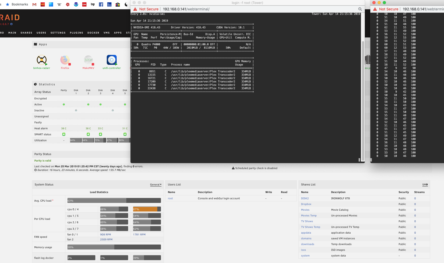

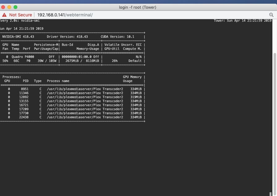

Here is an example of my problem. I scrolled the time bar on my iphone plex app 5 times and my Quadro got stuck at around 50% and my CPU was around 65%. I stop playing the file and it went down to 4-5% CPU and 0-2% GPU. But the Processes are still there.326674237_Screenshot2019-04-1421_15_42.thumb.png.04bd5ffd44637fc5e62c633a7d504a86.png
Thats more than 5 min later and they are still there.

I wrote a script that can be used to automatically re-apply the wrapper on a schedule so that when Plex is updated you don't have to manually re-apply the wrapper script.
That wrapper script is missing "exec"
See my gist post here:
https://gist.github.com/Xaero252/9f81593e4a5e6825c045686d685e2428
Lines 19-27 contain the wrapper script that executes the default "Plex Transcoder" which we move to "Plex Transcoder2"
You'll see there that I start each transcoder line with "exec"
To fix your wrapper (which would break with mpeg4 avi files):
#!/bin/sh
exec /usr/lib/plexmediaserver/Plex\ Transcoder2 -hwaccel nvdec "$@"
