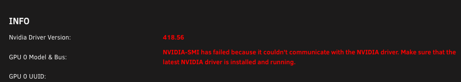

Hello Everyone. So I have been reading alot of these posts and have tried different things and have watched spaceinvaders video about getting my Nvidia P2000 to transcode my plex movies. I have been out of luck in this department. I am hoping someone could please help me through this. I would hate to let this card go to waste because I am dumb.

Hey guys,
I need some pleaseeee! So I jumped on a Dell sale for a p2000 about a month ago and just didn't have a chance to set it up with unraid although I did install it into my server.
Well I followed the instructions and I can't get the plugin to recognize it. "NVIDIA-SMI has failed because it couldn't communicate with the NVIDIA driver. Make sure that the latest NVIDIA driver is installed and running.   "
I then typed lspci -v, and it wasn't even listed, so unraid doesn't see the card? I went into the BIOS on my relatively new motherboard that I just bought, and it was already set to use the PCIE as the main graphics card and multimonitor was set to disabled (I currently have an i8400 and was using the igpu to transcode before. Even doing this, still the same result...
The fan on the card itself is spinning so I'm assuming that means the card is getting power? Could it be something wrong with my motherboard when both PCI slots are being used? (I'm using an IBM m1015 flashed to IT). I'm not sure what all this means. I would really appreciate some help guys. I'm running an ASRock H370M Pro4 board if that helps with the most recent BIOS

Do you have plex pass and did you follow the first posts to set up plex for hardware transcoding?
Yes. I do have plex pass. Yes, I followed the first steps on setting up plex for hardware transcoding.
