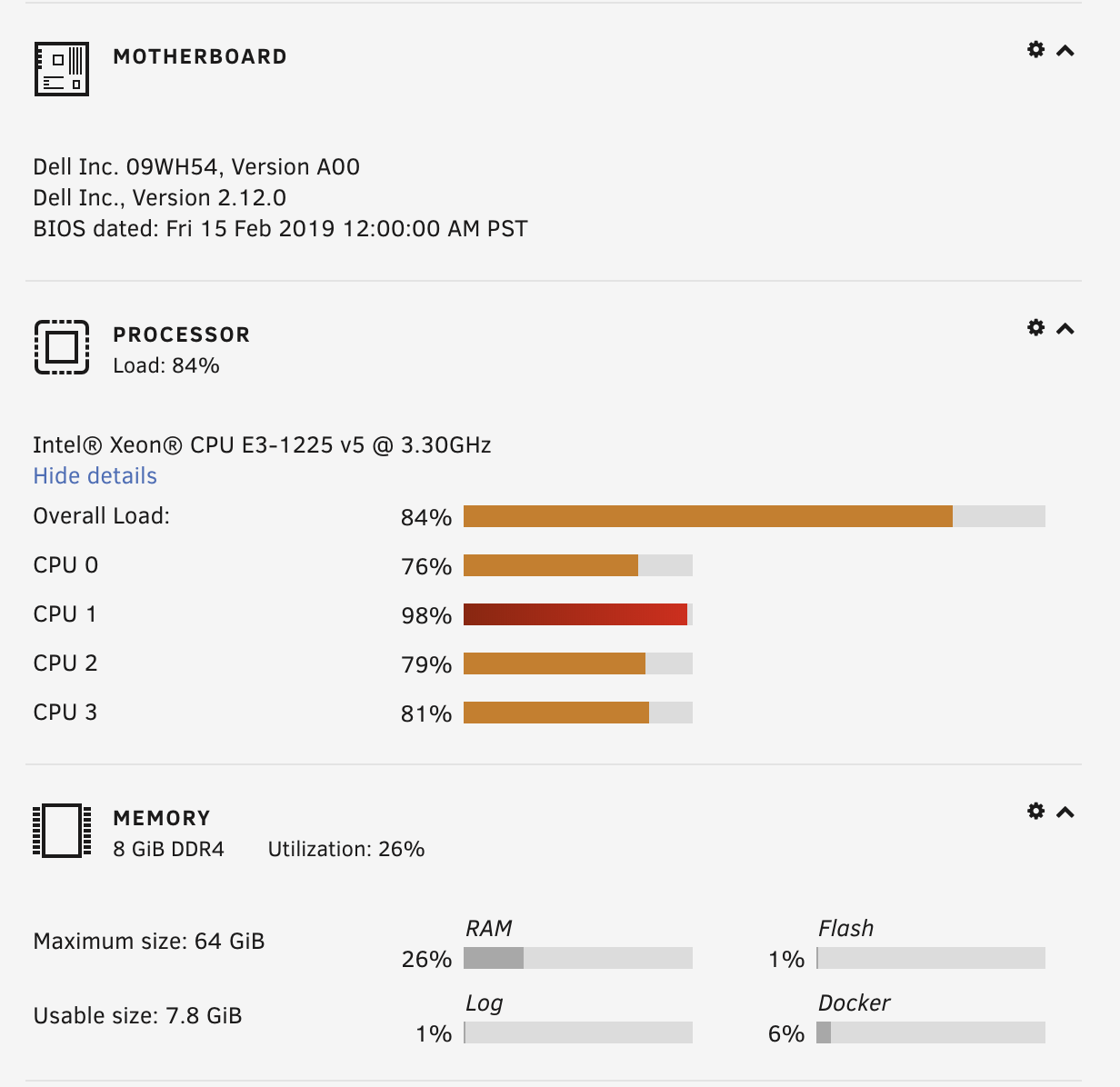

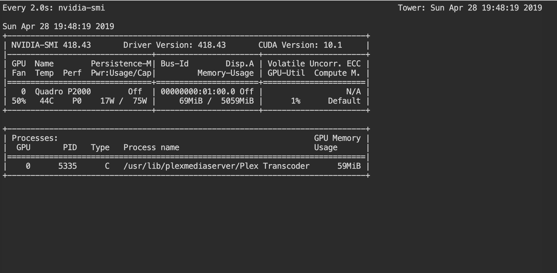

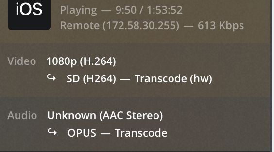

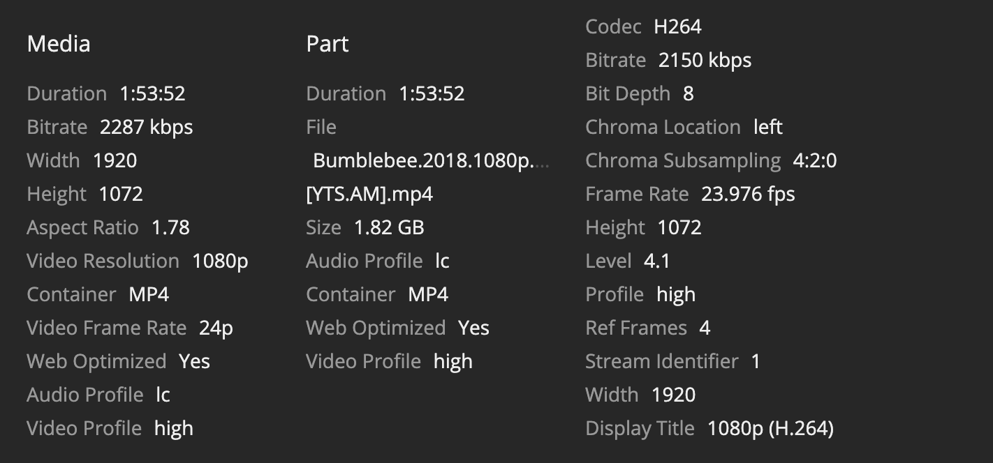

HELP!! Im a total noob and have followed every tutorial perfectly.  however, when i use plex or emby with my hardware transcoding (which seems to be working) my CPU is still at 97%.  I have a p2000 and a Dell T3620. I bought all this stuff and some how its not working like it should (or maybe it is) Attached are a few pics of my set up and Im not sure what i am doing wrong.  At this point id be willing to pay for some 1 on 1 tech support.  I can venmo or paypal. If anyone wants to make some cash please hit me up
do i need a new processor, ram, motherboard? Or is it a simple fix on the docker side.  I do not know linux commands so i am trying to read these posts but get a bit lost.
any help would greatly be appreciated.

You have to remember that Plex only use the GPU for encoding the video. That means that the video decoding is done by your cpu. In addition, the audio will always be transcoded by your cpu.
There are multiple posts in this thread about how to get plex to decode also, but it's not support by plex.
You could try emby, but you have to pay to get hardware transcoding.

That's pretty much to be expected.
When using QuickSync, Plex will both Decode and Encode using the Quicksync pipelines exposed by your CPU. When using nvidia's nvenc, by default, Plex will use your CPU for decoding, and nvenc for encoding.
You could create a wrapper that uses -hwaccel qsv to use QuickSync for decoding, and nvenc for encoding, which would result in similar CPU usage to using QuickSync.
At the end of the day, the nvenc/nvdec support is really only useful if you have a CPU that DOES NOT have QuickSync video.
