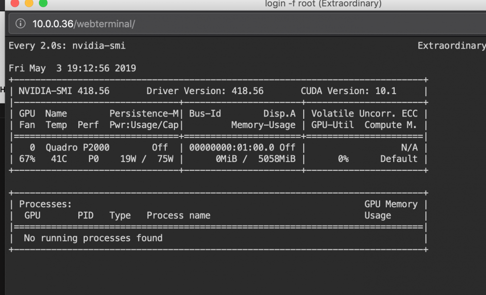

So the only thing I haven’t got is that my intel i7 8700k igup kicks in and is doing the transcode not the nvidia p2000. I’m testing with a 4K to 1080p in Plex.

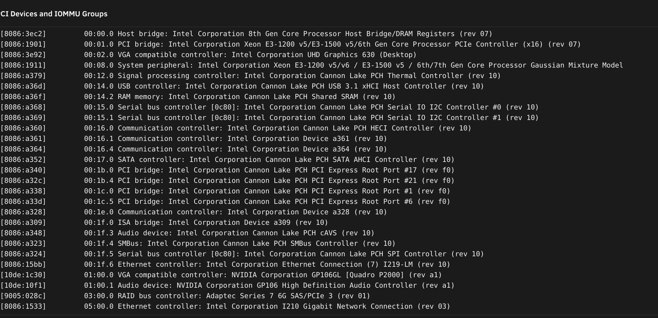

So here are my PCI system list. It is showing the igpu and my nvidia p2000. I have looked in my bios and there is no where were i can disable it, so i am hoping there is a way in unraid to disable this to have my p2000 take over. thanks everyone.
Pretty sure in Emby you can select which GPU to use, is there not a similar setting in Plex?

So in Plex there is no option to choose which gpu to pick. In plex its just that box you check and thats it to my knowledge. But I am a dumb dumb. So it seems to be working now. But my CPU seems to be still loading up when there is transcoding going on. From 4k to 1080p for my guests who only have a 1080p TV. The watch nvidia-smi shows my GPU working and its showing 3% to 6% but again the CPU is loading up like crazy. Alot of red lines in the dashboard which freaks me out.
Edited by acozad1
Have you bothered reading some of this thread or researching what plex is doing?
Plex is only using the GPU for encoding. It still needs to decode the video using the cpu. It also have to use the cpu for the audio decoding and encoding, so it will still use alot of cpu.
Really. I thought that my Nvidia P2000 would pick up a lot of the heavy-lifting. I did know that the audio would go through the CPU but that  Plex Media Server will attempt to use hardware-accelerated video codecs when encoding and decoding video. Dam. Well thanks for the help on this. I guess I may need to upgrade my CPU from i7 8900k to an AMD Threadripper or something like that.
But it says all that at the beginning of this thread..... in the readme.
And there are ways to get it to decode talked about in the thread.
You could have saved yourself a lot of time by reading.

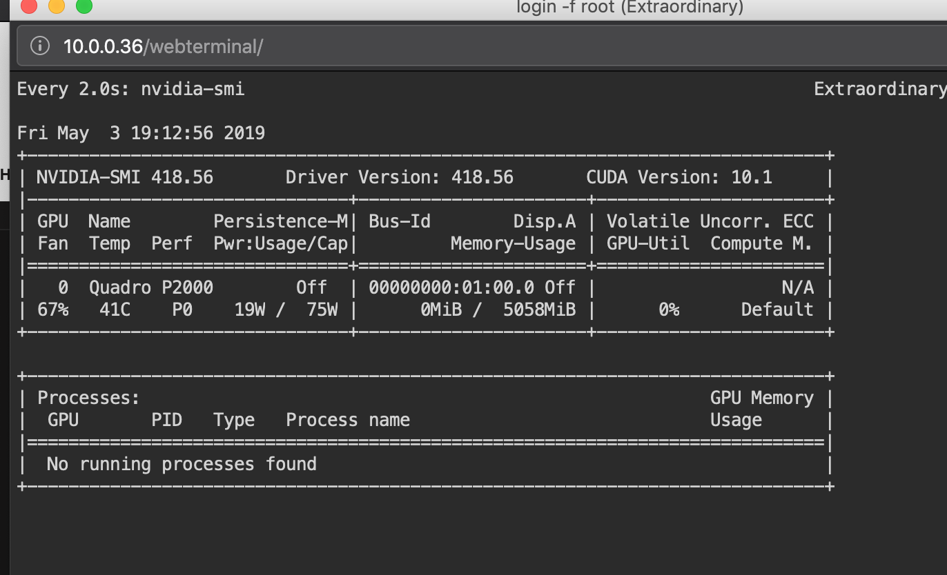

Has anyone else been getting their card disappearing and reappearing?  It works perfectly for a while but then just starts connecting and disconnecting.  Only way to fix it is a server reboot.  If I use watch nvidia-smi it will show up then disappear over and over.
i am using rc8 and a p2000.  Doesn’t seem reproducible.  Seems like it happens randomly.  But I only had this patch for two days and it’s happened twice already.
