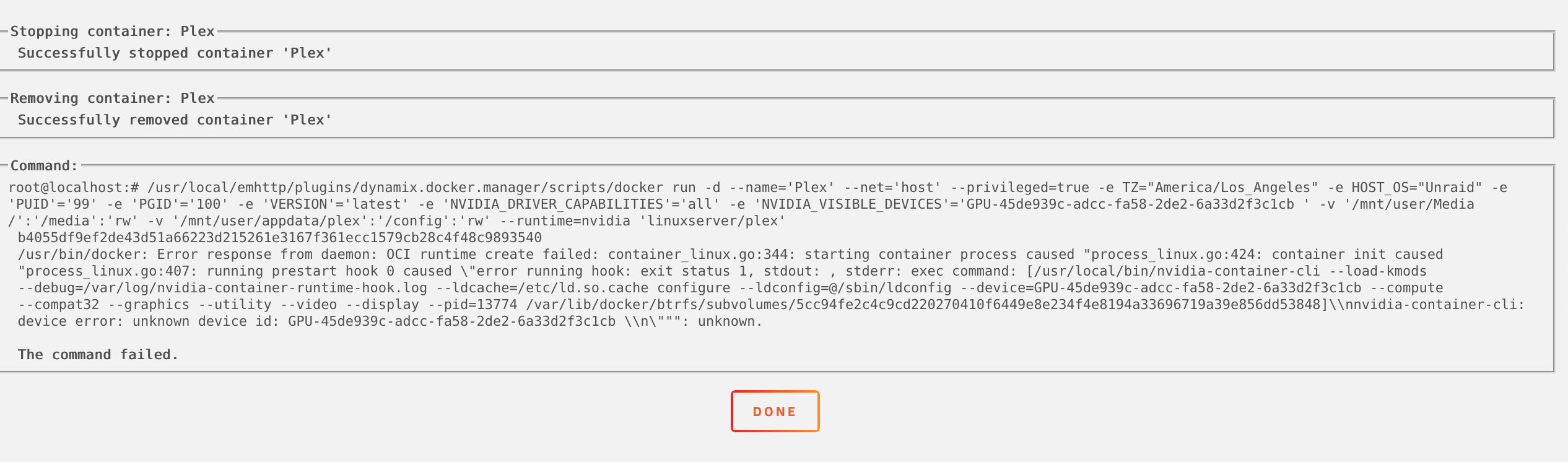

I know, I am going to catch shit for this. But I tried the new upgrade and it messed me up. Was unable to run it and had to downgrade to 6.6.7 and I am having a problem with my plex docker. I think I isolated it to the extra parameters --runtime=nvidia. it causes the docker to halt. Any incite on how to fix would be greatly appreciated.

you need the new driver build which has been discussed A BILLION TIMES ALREADY
Upgrading and downgrading when you're using the Nvidia plugin needs to be done via the plugin, using LT stock builds or the built in Unraid downgrade tools won't work.

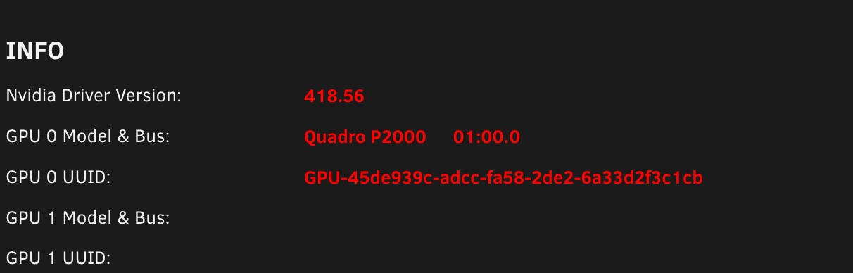

I have installed the nvidia driver and have installed the proper build for 6.6.7
Edited by acozad1
Just for clarity sake.  Do I only upgrade via the nvidia plugin?  Or do I upgrade unraid first then upgrade the nvidia driver(when it’s available).
You have an extra character in the end of the nvidia visible devices variable.
O shit. Great catch. I will edit that and try it again. Thank you for noticing and helping me out. I appreciate it.
That was it. You nailed it. Thank you again....
