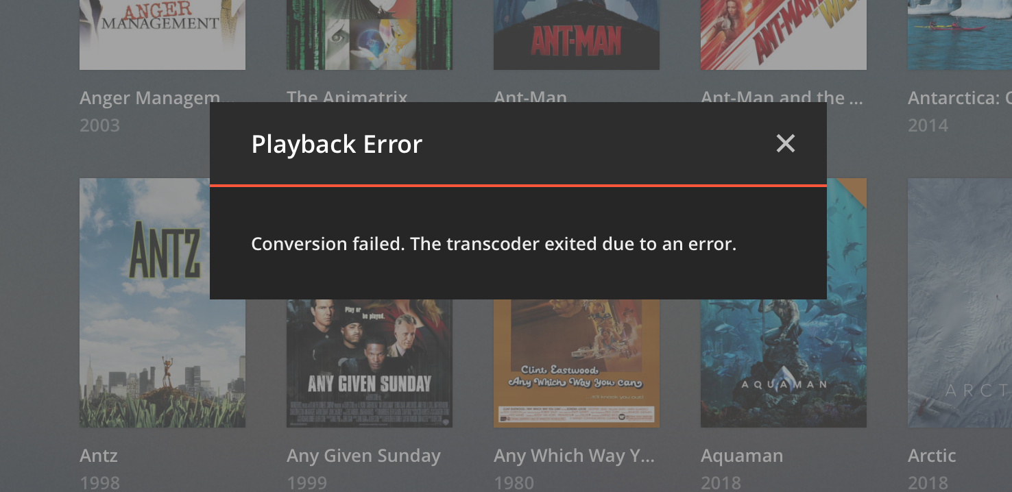

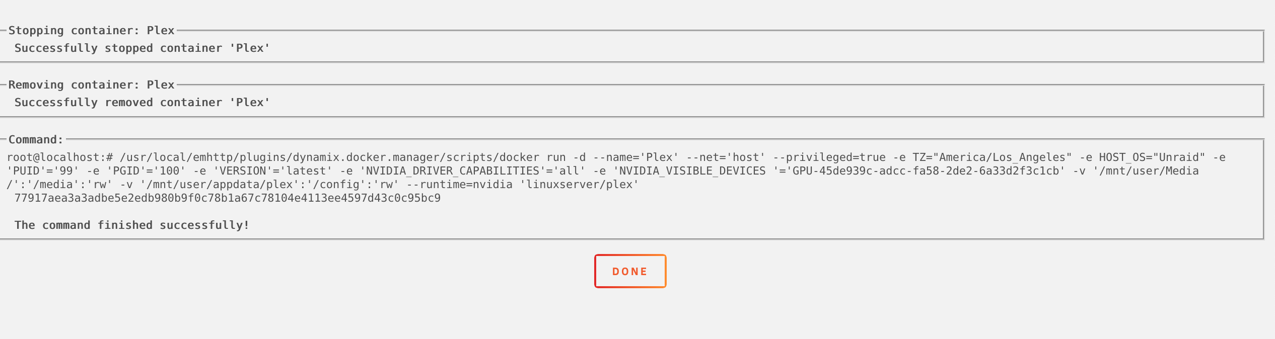

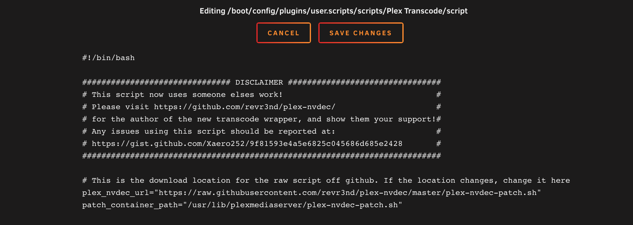

1 minute ago, acozad1 said:
yes, I am using this script for transcoding which worked when I was on rc8. But since the downgrade, which i think is giveing me this problem.
I don't support the patch, try without and if it still isn't working then post what I asked.  Otherwise you'd need to figure it out for yourself or speak to whoever is maintaining that patch

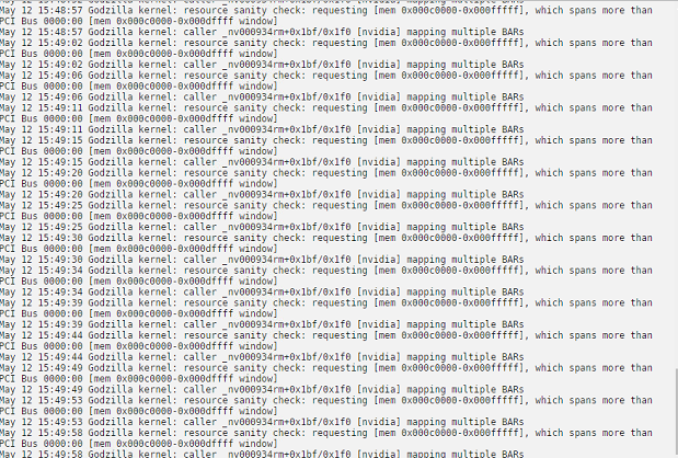

Im getting this over and over and over in my syslog since patching and implementing a 1070ti into my setup with plex. Is this an error? is it normal? does it even matter? I have the card in a 16x slot if this matters or not.
It doesn't look normal. But I have no idea what it means. Probably best to ask Google and see if it comes up with something.
Yeah I got no ideas either.
Are you using an AMD processor?
I get the same error's.
Nvidia trips AMD's processor security.
I have no more issues with my 1660 hardlocking my system because I disabled encrypted memory on boot.
mem_encrypt=off
No idea if Nvidia or AMD will fix it..
mem_encrypt=off
I don't have accounts to report it to AMD linux people nor nvidia.
I am! Ryzen 1950x I'll have to try this, thx! Are you saying this is on my motherboard settings or?
mem_encrypt=off needs to be added at boot for unraid.

3 hours ago, bradtn said:
Can you explain exactly where to put that flah and how to initially apply it? Thanks
Under Syslinux configuration
add to unRAID OS section.
