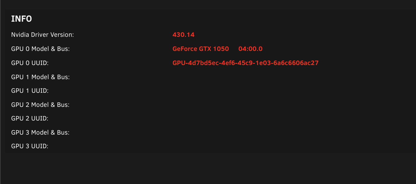

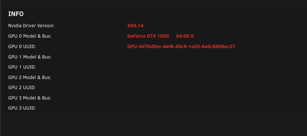

I have Updated to the newest version (6.7.1-rc1) but in (6.7.0) too. and booth Plex and ember don't use hw decoding or encoding.
i even can't use nvidia-smi it get the error:
root@Server:~# nvidia-smi
Unable to determine the device handle for GPU 0000:04:00.0: Unknown Error
I'm using a gtx 1050 ti and I know that it was working before.
and from unraid logs all seems to be ok:
May 27 22:39:47 Server kernel: nvidia: module license 'NVIDIA' taints kernel.
May 27 22:39:47 Server kernel: Disabling lock debugging due to kernel taint
May 27 22:39:47 Server kernel: nvidia-nvlink: Nvlink Core is being initialized, major device number 246
May 27 22:39:47 Server kernel: nvidia 0000:04:00.0: enabling device (0100 -> 0103)
May 27 22:39:47 Server kernel: nvidia 0000:04:00.0: vgaarb: changed VGA decodes: olddecodes=io+mem,decodes=none:owns=none
May 27 22:39:47 Server kernel: NVRM: loading NVIDIA UNIX x86_64 Kernel Module  430.14  Wed May  8 01:10:53 UTC 2019
May 27 22:39:47 Server kernel: nvidia-modeset: Loading NVIDIA Kernel Mode Setting Driver for UNIX platforms  430.14  Tue May  7 19:58:01 CDT 2019
May 27 22:39:47 Server kernel: [drm] [nvidia-drm] [GPU ID 0x00000400] Loading driver
Edited by Wuast94
Does all the relevant info appear on the plugin screen? Post a screenshot
Also are you using that damned Plex script?
If you are try without otherwise we won't help unless it's removed from the equation.
Sent from my Mi A1 using Tapatalk
yes as you see :)
now I don't use any script or is it a standard that is activated or installed by default ?
and in emby shouldnt be any Plex script I think ? :)
yes as you see [emoji4]
and in emby shouldnt be any Plex script I think ? [emoji4]
That tells me nvidia-smi is working though as that's how I get the information displayed there.
watch nvidia-smi is the command and it runs on Unraid not in the docker container.
