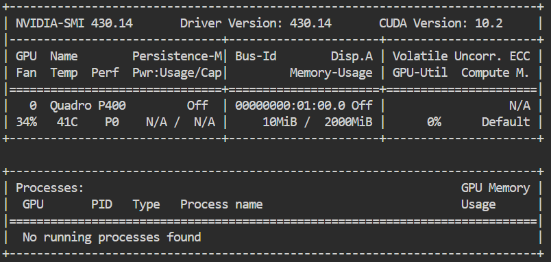

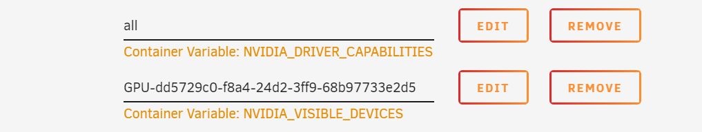

1 hour ago, andy harris said:
hi having a few issues getting transcending to work with plex
setup
p400
unraid 6.7.2
unraid nvidia
plex parameters
everything looks like it OK adding the parameters passes
but no matter what i do i get get streams to encode via gpu they are all using the cpu (i know this barbecue cpu usage goes through the roof
any help would be appreciated
Do you have plex pass?
And did you add the --runtime=Nvidia to the extra parameters box?
yes and yes

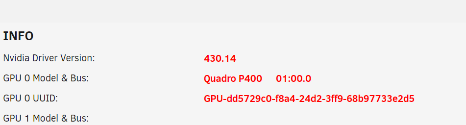

14 minutes ago, andy harris said:
yes and yes

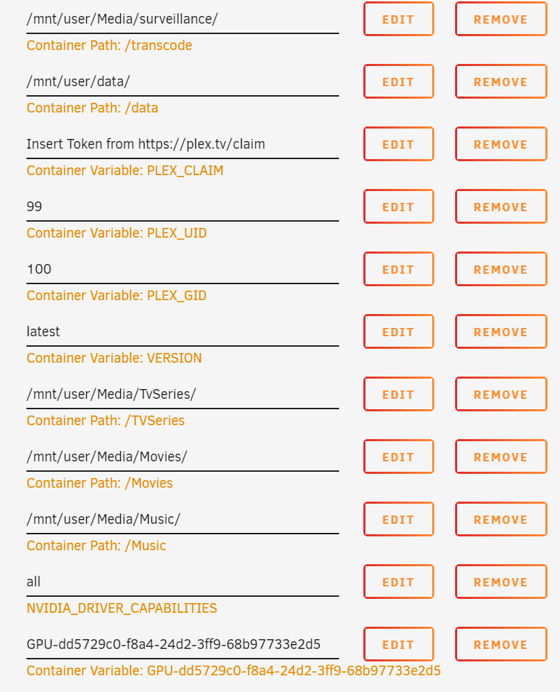

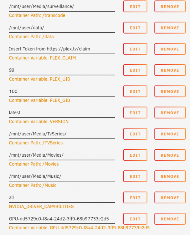

is this variable correct? seems like it isn't.
sorry must have been one of the many time i have tried from scratch to get it working it does read the correct value
still does not work it just seams to send cpu usage through the roof and nothing in nvidia-smi

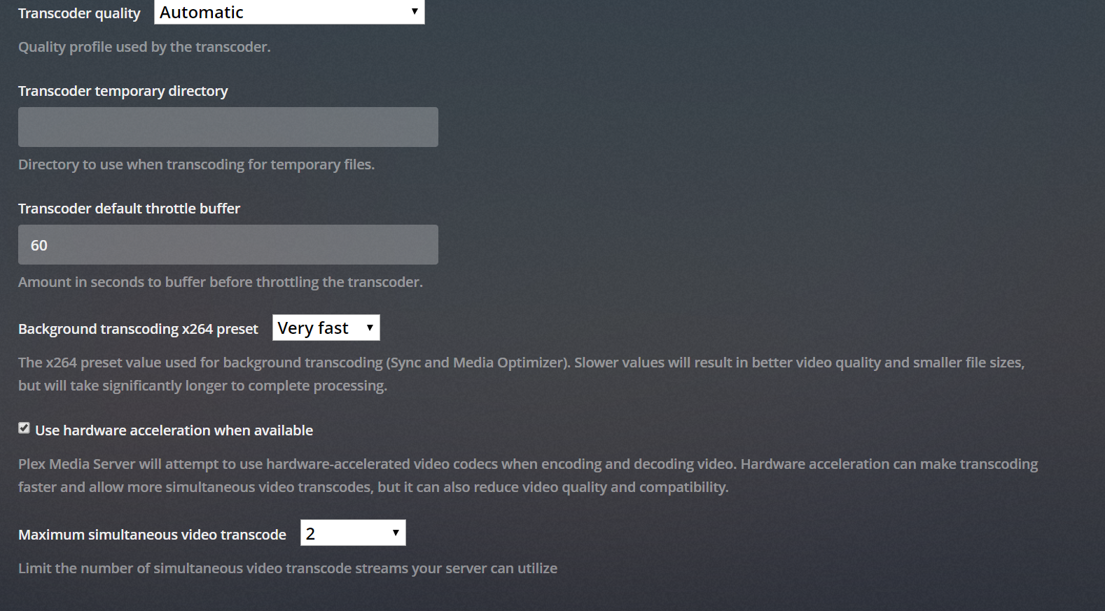

I also suppose that you check the Plex server settings to add the checkbox in the « use hardware to transcode » or something like that in the transcoder settings ?
Are you copy/pasting stuff from the forum to setup these variables? that can cause issues.
right like i have sort of fixed it plex will now trans code via the p400 but i am still getting cpu usage through the roof (is that normal) i was expecting it to lower my cpu usage
i have no idea what i did different i just deleted the packages and started again
Edited by andy harris
