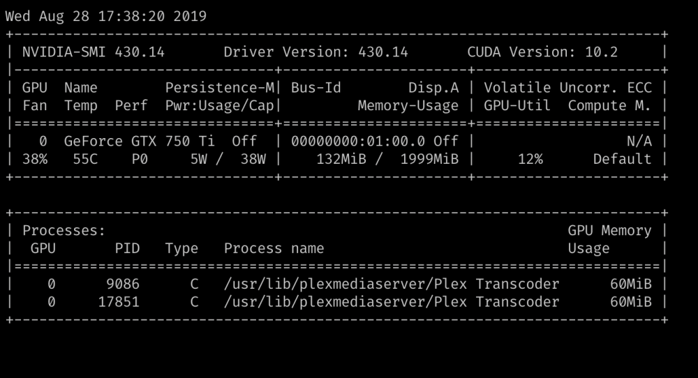

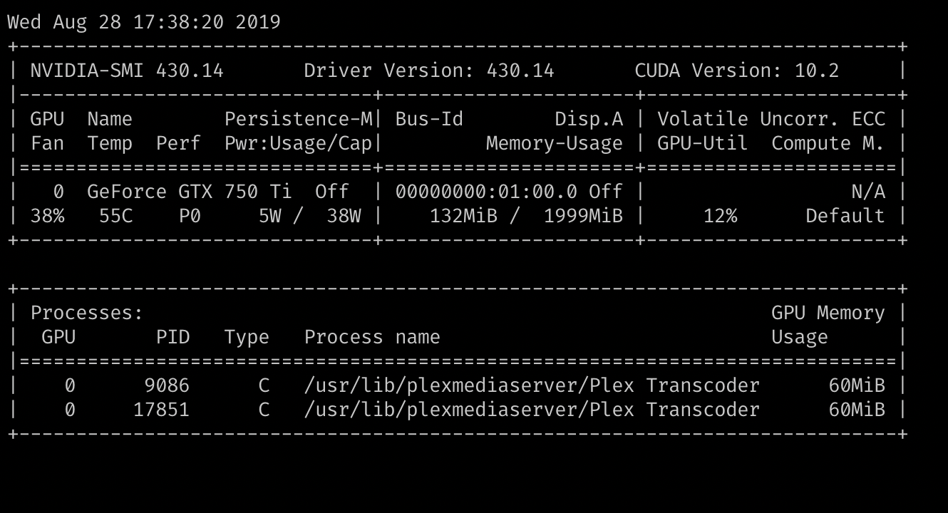

Interesting that Plex needs a specific driver for decode / encode yet emby has been working fine since release.
5 hours ago, msilkjr said:
Hello all,
Plex now requires nvidia 430.18 and the unraid nvidia build 6.7.2 only has 430.14. is there a way to update the driver or an ETA on a new build?
I had to disalble hardware transcoding in plex as it stopped playing.
When you had it enabled, and you went to start a transcode would it crash your system? I replaced my motherboard last weekend and have been trying to get back to stable. All the times I get a transcode started again with the correct set up, it hangs the full system, and I have to hit the reset button. I am trying to figure out if it’s something I’m borking or a mobo issue, or something else.
Disregard comment, I forgot to add the runtime variable to extra parameters. I are stupid.
Edited by urhellishntemre
When running nvidia-smi dmon, I can see both enc and dec activity. Interestingly, it seems something with Tautulli isn't caught up yet. Tautulli still shows "hw" for encoding only, not decoding. Is anyone seeing "hw" for both with this new version of Plex and 6.7.2?
I re-enabled Hardware Transcoding. starting one stream is ok. starting a second one i see it in nvidia-smi but plex just spins and never plays. this only started after the last plex upgrade. if I uncheck hardware transcode in plex it all works again.
