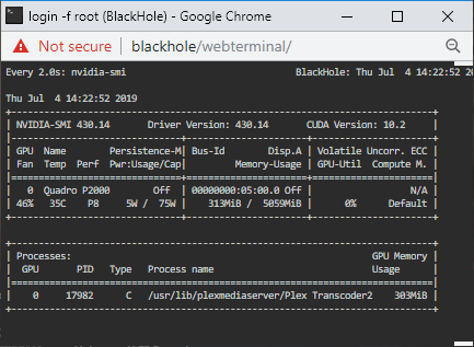

4 hours ago, Xaero said:
I was under the impression that Emby doesn't have this behavior?
To see if it does, and part of "why" run
watch nvidia-smi
Check the power state is not latched to P0.
Start a stream, verify the power state latches to P0
Stop the stream, verify the process has ended, and that the power state is stuck in P0
Run fuser -v /dev/nvidia*
To see what processes are still using the driver.
Card is always at P0
Stream or no stream.
I will wait to see if someone creates a docker or script to fake the desktop to trick nvidia's cards into letting us not having to run P0 24/7
Run fuser -vk /dev/nvidia* and see if the p state changes.
It should boot to a p8 state even with no X server, from playing with this. Chances are some process is not ending properly
fuser -v lists open handles on the specified file(s) since devices are treated as files in Linux land, it can be used to see what process has a device open.
You can then either kill listed PIDs individually, or just specify the -k option to have fuser kill the processes on its own.

I think you didn't enable the persistance-mode. Do that before testing with: nvidia-smi --persistence-mode=1
sorry, your right.
Once i run the command it works :)
I just have to set persistence mode on at each boot :0
* i justed tested emby, it latches to p0 for transcodes and goes back to p8 once trasncode stops!*
Edited by Dazog

3 hours ago, Max said:
looks like you were right since yesterday after i updated my plex docker my gpu goes back to p8 state as soon as its done transcoding. Now finally my core and mem clocks goes back to idle.
and you know what the irony is with nvidia, my gtx 750 runs just fine probably because 750 runs on maxwell and 760 runs on kepler but isn't its supposed to be other way around.😅
i wouldn't suggest going with jellyfin just a week i also gave it a try as with plex and emby you have to pay for hwacell but it was so glitchy for me that i uninstalled it in a matter of minutes.
Which docker do you use? Sounds very interesting with the P-states!
sorry i was wrong it's decode only thing, it only goes back to p8 state if it was being used for some decode only process which i guess is only when plex is generating video preview thumbnails but once u use it for transcoding or encoding then it never goes back p8 states.
once again im sorry for being stupid😅
And I tried all plex dockers this evening to prove your point! Emby it is then! Thank you anyways!
