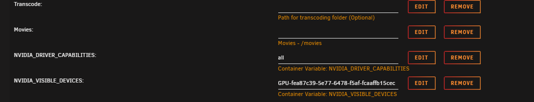

Is it direct playing? If so there’s no transcoding needed.
Also are you passing in the nvidia runtime param in the container’s “extra parameters”?

After your comment and (re)watching the added below YouTube vid, I got it working! Got it working using pcie_acs_override=downstream,multifunction and modprobe.blacklist=nouveau. Thanks a lot! Can boot VM with my 2080 AND transcode vids on my 750. Thanks again!
modprobe.blacklist=nouveau is not needed as the driver isn't included in unraid. Might be in the gui boot.
